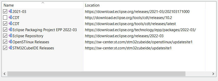

The "automatic updates" show me a new version 1.11.0. After starting the process it stops with following error:
Problem Occured.
'Updating Sortware' has encounterd a problem. An error occured while collecting items to be intstalled
The details>> shows a large list of errros like this:
An error occurred while collecting items to be installed
session context was:(profile=STM32CubeIDE, phase=org.eclipse.equinox.internal.p2.engine.phases.Collect, operand=, action=).
No repository found containing: osgi.bundle,com.st.stm32cube.common.mx,6.7.0.202211181646
No repository found containing: osgi.bundle,com.st.stm32cube.common.mx.oss,6.7.0.202211181646
No repository found containing: osgi.bundle,com.st.stm32cube.common.mx.stinsider,6.7.0.202211181646
No repository found containing: osgi.bundle,com.st.stm32cube.ide.common.services,2.1.400.202207051747
And so on.
My available software sites under "preferences -> Install/Update" are
0693W00000WJz6QQAT.pngWhat to do to solve this problem?
Please help me.
Thanks Hans

What happens if you force the Reload of STM32CubeIDE Release repository in above prefs page ?
JBabl.1
JBabl.1Author
December 2, 2022
Hello Julien,
Thanks for the advice, but the update then aborts with the same error message. The subsequent reload of all repositories does not change anything either. I'm at a loss.

Julien D
December 2, 2022
If all the reloads worked fine then I don't see other solutions than manually deleting the cache folders
STM32CubeIDE\p2\org.eclipse.equinox.p2.repository\cache
STM32CubeIDE\p2\org.eclipse.equinox.p2.core\cache
STM32CubeIDE has to be stopped for this operation.
You might also have to check that you have well access to the failing plugins through a web browser, just to eliminated the possibility to have any IT softwares preventing access to those URL...
Ex: https://sw-center.st.com/stm32cubeide/updatesite1/1.11.0/plugins/com.st.stm32cube.common.mx_6.7.0.202211181646.jar
=> Download can be cancelled if begun

Deleting these two cache folders dosn't help.
No problems accessing and download the suggested .jar file
Downloading for example the STM32Cube MCU Package for STM32F7 Series 1.17.0 also no problems.

Let's eliminate any conflicts between software sites, keep only a check-mark on the 2 sw-center.st.com urls and try again.
If still not working please share your workspace log files (workspace_path/.metadata/*.log) to see if it guides us.
JBabl.1
JBabl.1Author
December 2, 2022
Also not working.
