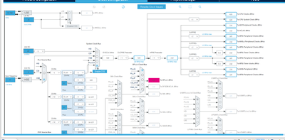

I'm using STM32H743ZI with STM32CubeMX 6.9.1.
I used to work with an really old STM32CubeMX , and I decided to move to the latest version of both IDE and MX
so I had to configure the IOC file from scratch manually - since migrate wasn't possible (too old)
I copied the same configuration like the old IOC file , and the same for the clock configuration - but in the clock configuration I saw an issue - I can set the SPI123 to <=200 MHz while the max size is 480 MHz
so I searched online and saw few solutions that didn't work such as:
https://community.st.com/t5/stm32cubemx-mcu/stmh743zi2-cubemx-clock-setup-max-frequency-not-allowed/m-p/148775
https://community.st.com/t5/stm32cubemx-mcu/cubemx-stm32h753iikx-clock-configuration/m-p/98576#M2796
this is my clock configuration:

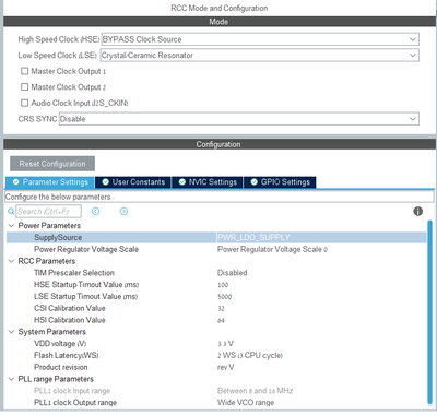

also my RCC configuration:
pls I need your help :)
thanks

Hello @Mz.1,
The maximum allowed SPI frequency :
VOS 0 : 200MHz
VOS 1 : 200MHz
VOS 2 : 150MHz
VOS 3 : 100MHz
Foued

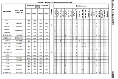

Foued_KH
September 4, 2023
Hello @Mz.1 ,
You can refer to this article : How to reach 480MHz for STM32H7xx MCUs ? - STMicroelectronics Community
Hope it helps!
Foued
Mz.1
Mz.1Author
September 4, 2023
@Foued_KH - thank you for your answer!!!
I did checked the datasheet and the errata and the print screens in the link you sent.
tried to do the same but still same issue.
if you'll see in the images I sent above - it happens only in the SPI123 so maybe it's different issue? I don't know
it worked with the old STM32CubeMX so it's version related for sure.

Hello @Mz.1,
VOS 0 : 200MHz
VOS 1 : 200MHz
VOS 2 : 150MHz
VOS 3 : 100MHz
Foued
Mz.1
Mz.1Author
September 4, 2023
@Foued_KH - thanks for the answer but this is odd...
when I used an old version of STM32CubeMX (6.5.0) I could set up the SPI123 clock up tp 480 MHz.. or it wasn't actually true?
Foued_KH
September 5, 2023
Hello @Mz.1 ,
I think the problem is fixed in the new STM32CubeMx version
Foued
