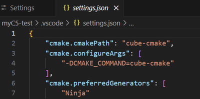

No one (at least on Linux---not sure what Windows users do these days) is going to want to modify their system path to add a weird bin directory just for a single application.  The right way to tell cmake where to find the tools is to either modify *its* environment or give it full paths to each tool.  But the extension did not do this when it was installed---I think that is a bug because it is easy to automate.
Complicating matters further, there are several places that cmake can be told where the tools are, but it turns out some of them get overridden and hence don't work.  For example, google's AI suggests to add CMAKE_C_COMPILER with the full path in CMakeLists, but that didn't work.  I finally figured out that I needed to create a .vscode/settings.json file with the stanza
"cmake.environment": {
"PATH": "/home/mark/.local/share/stm32cube/bundles/gnu-tools-for-stm32/13.3.1+st.8/bin:${env:PATH}"
(Interestingly, after I made the file, the extension added a bunch more stuff to it, but it didn't get created as part of the install.)
Again, it seems like this would be trivial for the extension to do automatically as part of the installation, since it knows exactly where the toolchain is located.

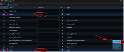

1) Move to bundles manager view and select your project
2) Select ninja & cmake tools, elect versions and pust `Set` button
3) Look at your bundles.store.json file : cmake & nija has to be here !

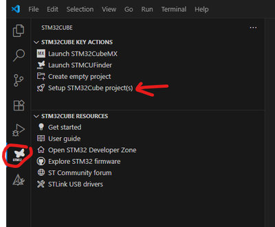

Have you some metadata added to the project ? Sounds the way the stuff is supported.
If not having them ? maybe setup project is helpful ?

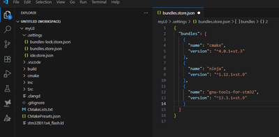

My bundles.store.json looks like this:
 "bundles": [
 "name": "st-arm-clangd",
 "version": "^19.1.2+st.3"
 "name": "gnu-tools-for-stm32",
 "version": "^13.3.1+st.8"
 "name": "stlink-gdbserver",
 "version": "7.10.0+st.3"
(I installed ninja using my OS package manager because the STM32 VSCode extension also couldn't find its own ninja installation.  There's probably a way to fix that too but I didn't pursue it because installing my own ninja was an easier solution.  I also have cmake already installed on my system.)
On my computer, "Setup STM32Cube project(s)" is shown but it is grayed out.  I'm not sure what that means.  I don't have STM32Cube stuff installed separately.  I only installed the STM32 VSCode extension and the system bundles shown above.  We're not supposed to install Cube outside of that process, are we?

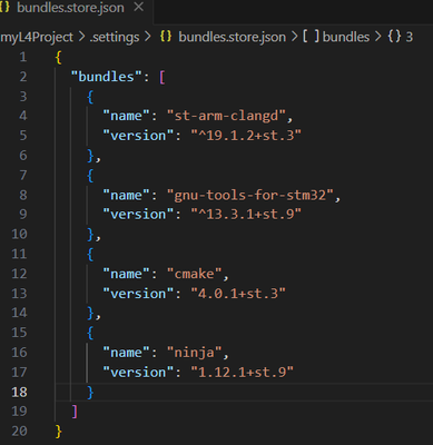

@mark03 your shared bundles.store.json looks promising but is not complete. You should get as extra from early begining cmake & ninja as part of.
Yes you're right CLT is gone with this fresh initiative and is self sufficient Thanks some new objects so called STM32Cube bundles allowing to serve the same but more smart, flexible way enabling partial update, continuous delivery more, more control to the end user.
Working this way, yes, path management is handled under to hood for you and you have as end user to take no care about. Already it's bare minimum service we want to serve plus ambition to promote unique flexibility to end user. Flexibility considering Thanks this fresh bundle system and under the hood mechanism, you will be able to get PATH like definition per project and not global to your VSCode instance or worse to your system. Bundle system is managing dynamically and under the hood PATH definition. To understand it a bit more (yes we are working on some documentation, apologize for delay) please have a try from a VSCode integrated terminal to run the following command from root directory of your project (location where .settings folder is):

Having as expected cmake & ninja as part of your bundles.store.json you should be able to run the following commands:
cube cmake --version
cube ninja --version
.. getting as result proof these tools are set and starting to get you understand based on bundles.store.json (project based so) you could get version of tool(s) you want per project.
Based on your bundles.store.json the following should give some results the same:
cube stlink-gdbserver-pure --version
Please note, about cmake setup especially, you have to take care to not jeopardize tricks set to make it happens at the end. May sounds weird but forced to us enabling smooth integration keeping CMake Tools extension running what, we guess, all are appreciating.
Here are piece of explanation pending more accurate documentation.
Real issue is why are you not getting expected bundles.store.json file content ?
Could you have couple of trial forcing by hand ninja & cmake setups ? ... in order to see the system acting and helping us to support you acting as kind of local install sanity check.

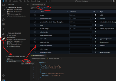

Thanks for the helpful walkthrough!  I went to the VSCode terminal like you said and was able to run those commands with no problem.  Then I double-checked the bundles manager and I see two entries (just like your picture), one for System and one for my project.  If I look at "System", cmake and ninja are both installed.  If I look at the bundles for my project, they are not installed.  Could this have something to do with using the "empty project" option?
I went ahead and selected the installed versions for cmake and ninja, then pressed Set, like you showed, for my *project* bundles list.  Then I deleted the build folder and ran cmake configuration.  Now everything works.  (I even got rid of the path statement in my .vscode/settings.json.)  So it looks like this was the problem all along---cmake and ninja bundles were installed but for some reason not selected in my project, and it was trying to find them in the system path.
