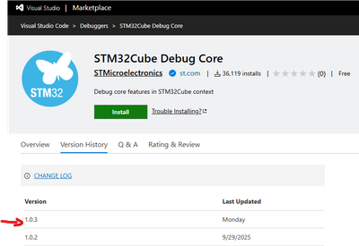

Nov 25, 2025 6:36 AM UTC
@Burrr @Andrew Neil @ArnaudC @Cartu38 OpenDev
Please be aware that the issue has been fixed and the extension update is now available.
