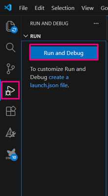

3. Validation
After building the application, select the Run and Debug icon. Create a debug session by selecting the STLINK GDB Server option:
Use the Watch feature in Visual Studio Code’s Run and Debug tab to monitor the RTC date and time variables. Set a breakpoint inside the while loop. Note: RTC continues to run in the background even when the debug session is paused.
