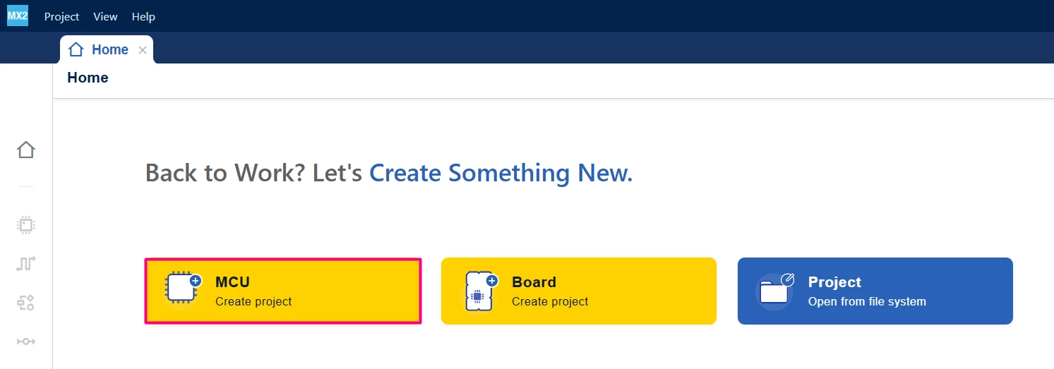

Open STM32CubeMX2. On the Home page, click the MCU square to create a new project.

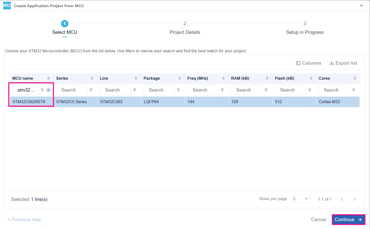

In the search field under MCU name, enter STM32C562RE and select the MCU. Click [Continue].

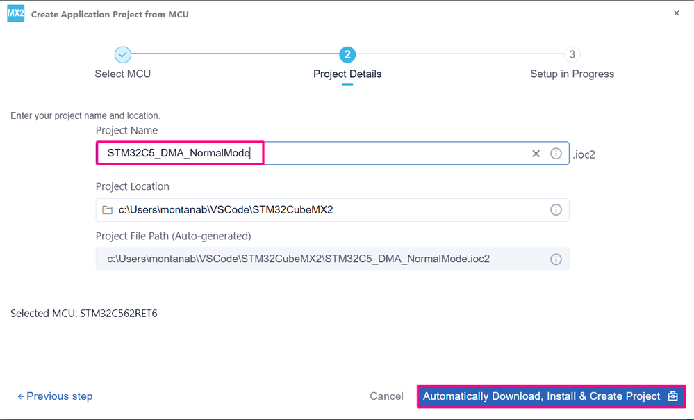

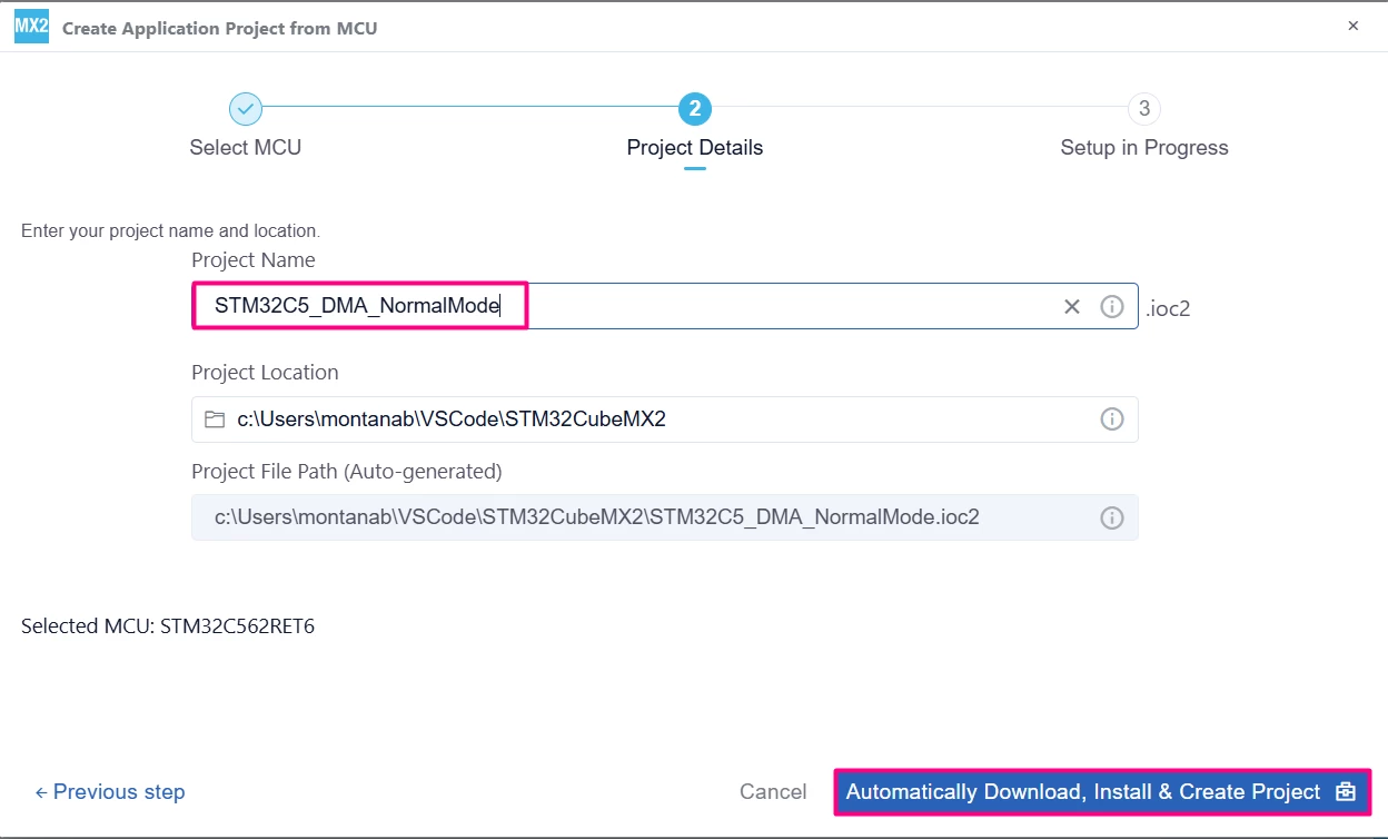

Enter the project name and location. Click [Automatically Download, Install & Create Project] to finish project creation.

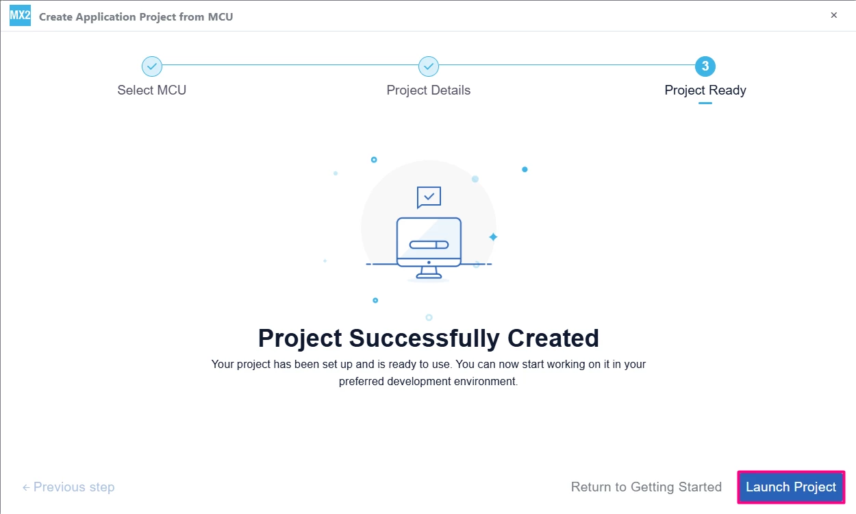

Select Launch Project to start.

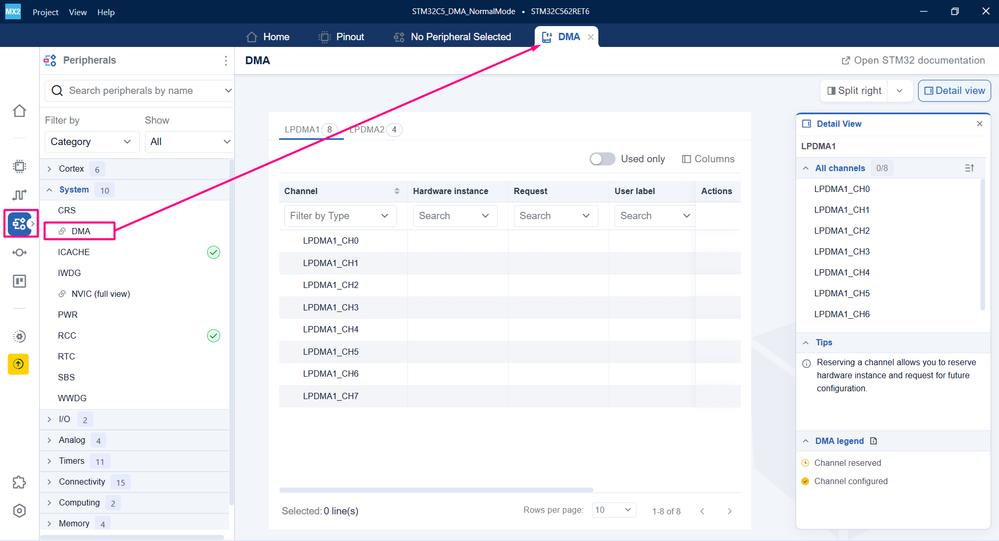

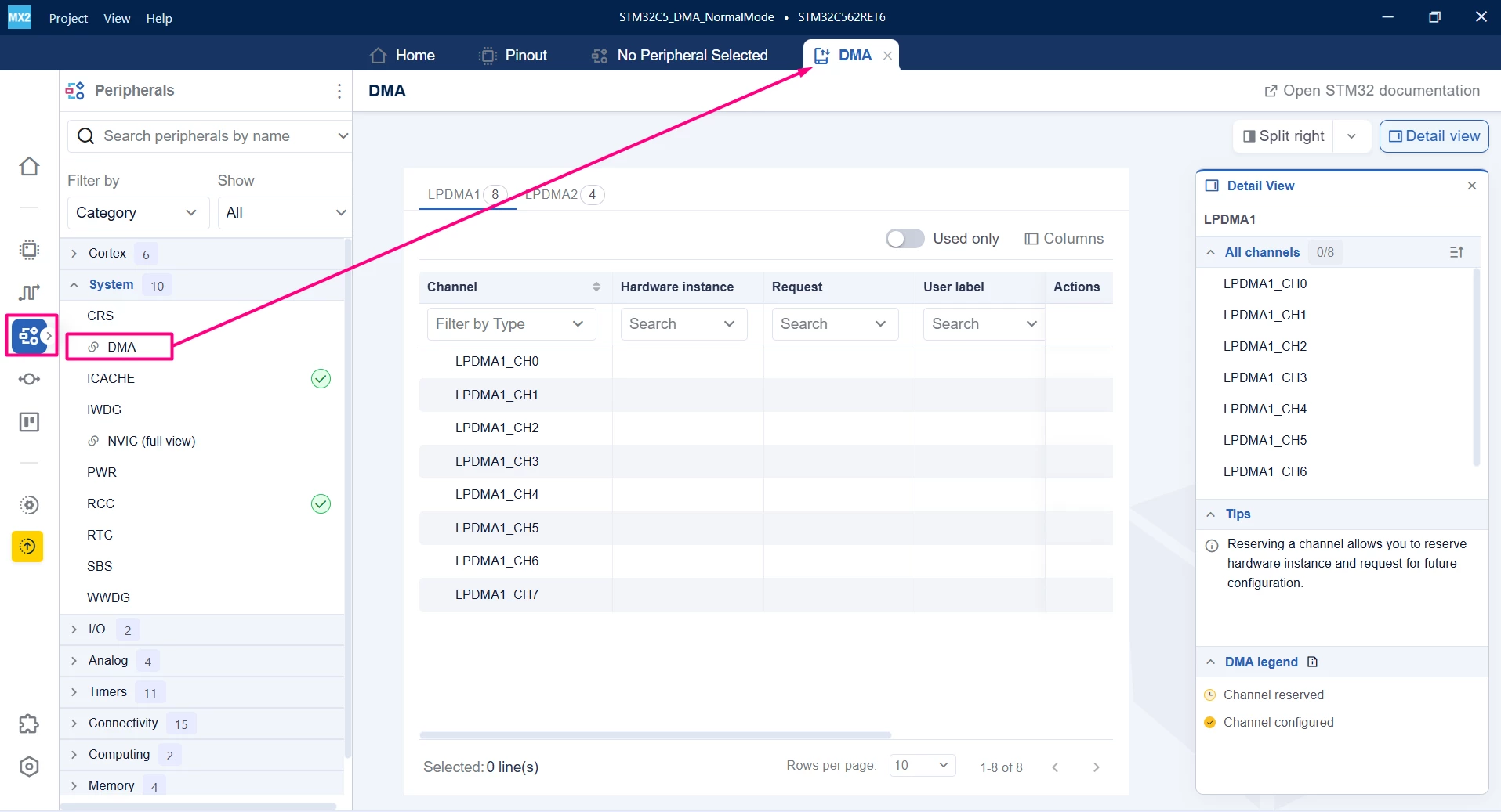

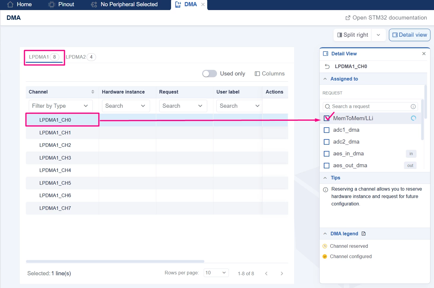

  1. Navigate to the Peripherals tab and open the System drop-down list and select [DMA].

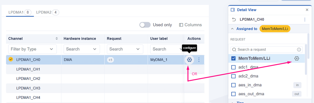

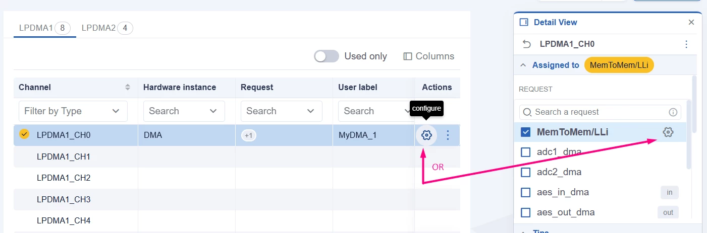

  1. In the DMA System View page, go to the LPDMA1 tab and select channel [LPDMA1_CH0]. Assign the selected channel to MemToMem/LLi.
  1. Click the gear icon next to MemToMem/LLI to configure the channel.

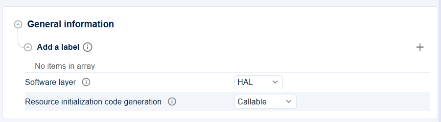

  1. In the LPDMA1_CH0 page, go to the "General information" tab and set Resource initialization code generation to [Callable].

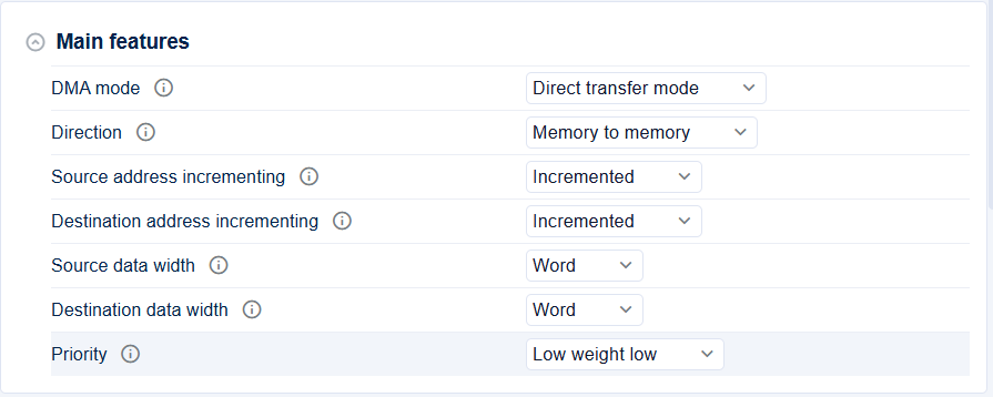

  1. In the Main features tab, configure the DMA channel as required. Use the "Memory to memory" direction, incrementing both Source and Destination address and set the data width for both as Word.

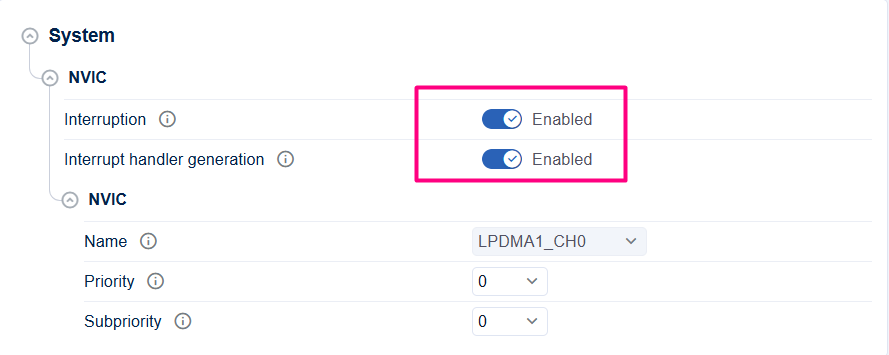

  1. In the System tab, enable both [Interruption] and [Interrupt handler generation] options.

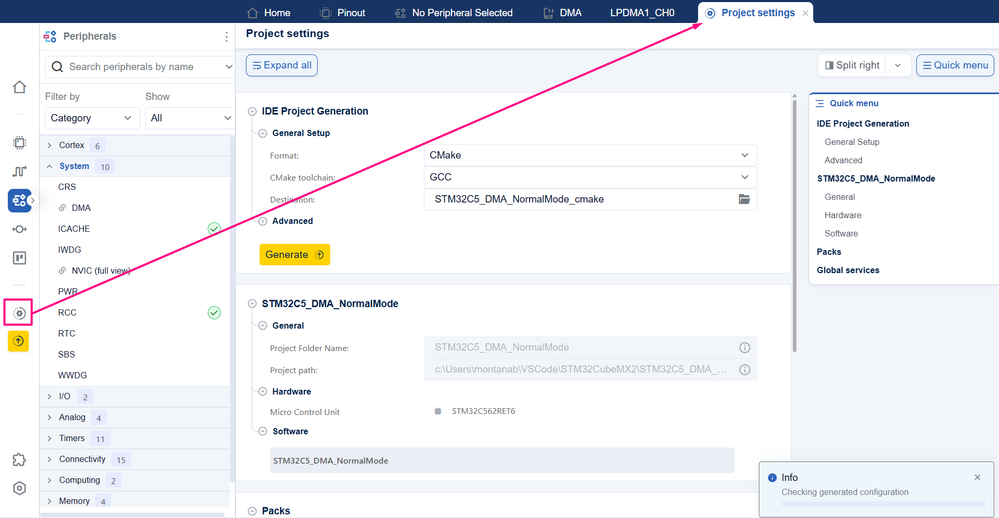

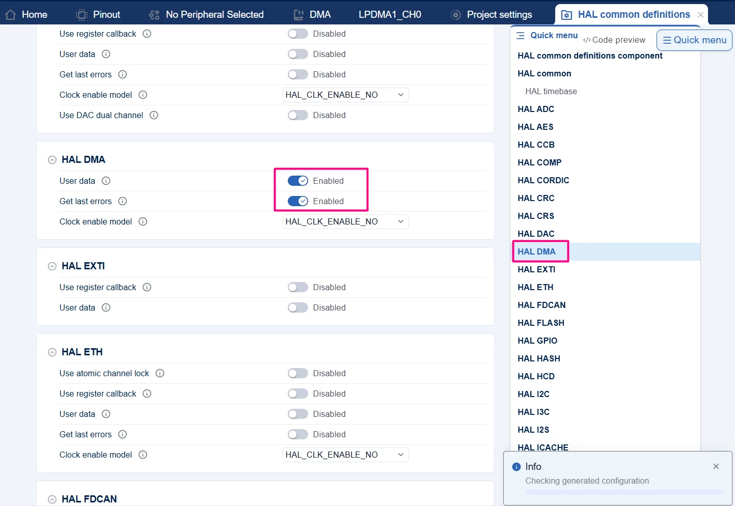

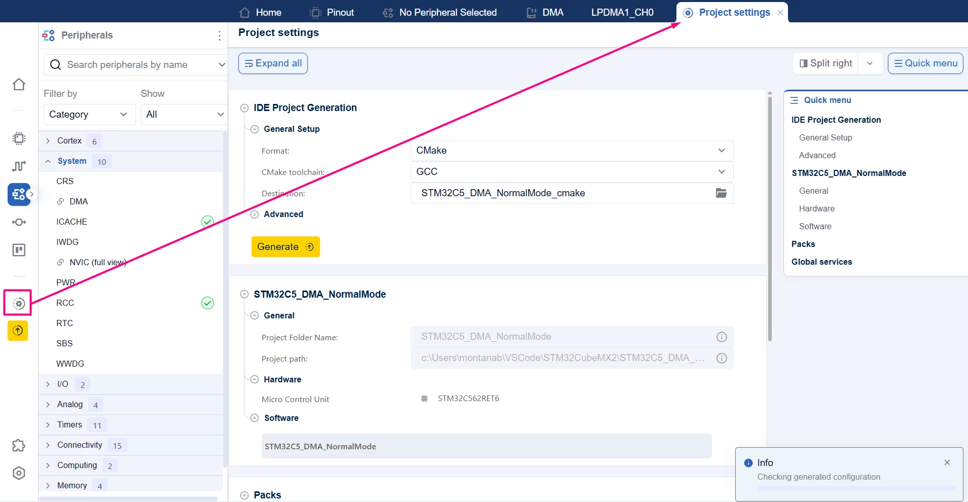

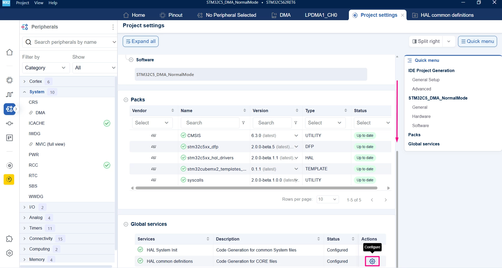

  1. Select the [Project settings] icon.
  1. In the HAL common definitions, use the quick menu to locate the "HAL DMA" category and enable [User Data] and [Get Last Errors].

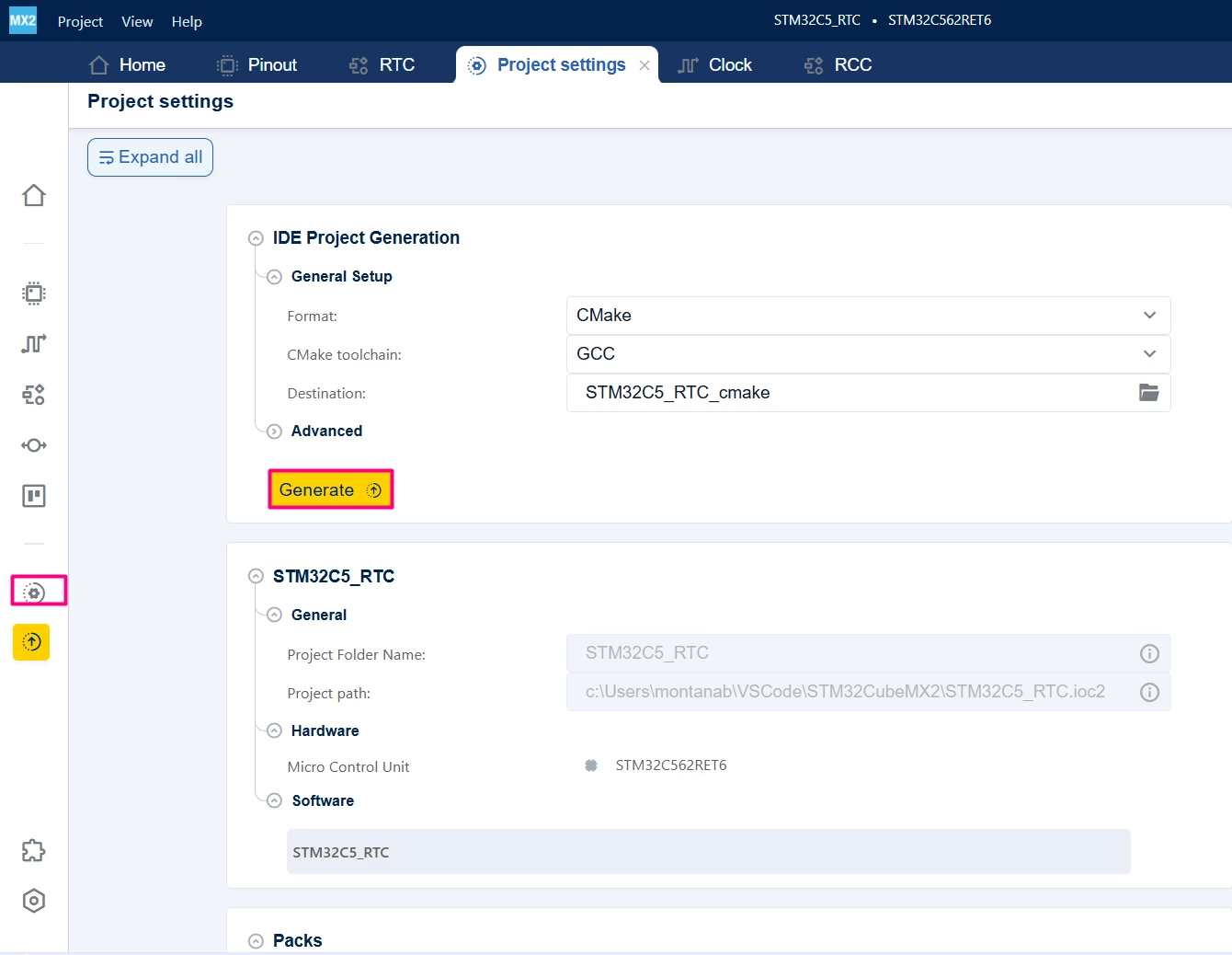

  1. Click on the [Project settings] icon and select the desired IDE.
  2. Click the [Generate] button.

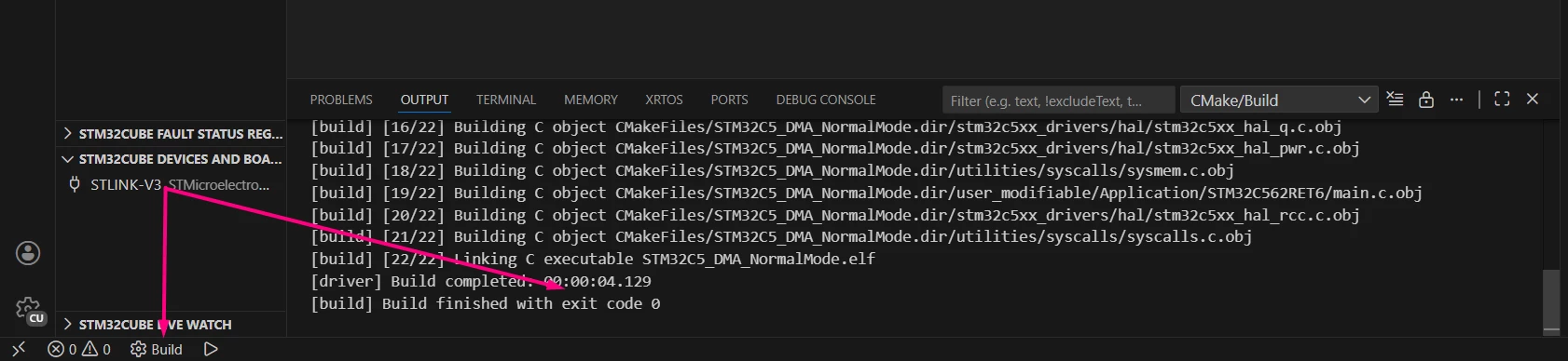

If prompted, select the configuration. If not prompted, press Ctrl+Shift+P, type CMake: Select Configure Preset, and choose the debug configuration.
Build the project to ensure everything is set, then proceed to code implementation.

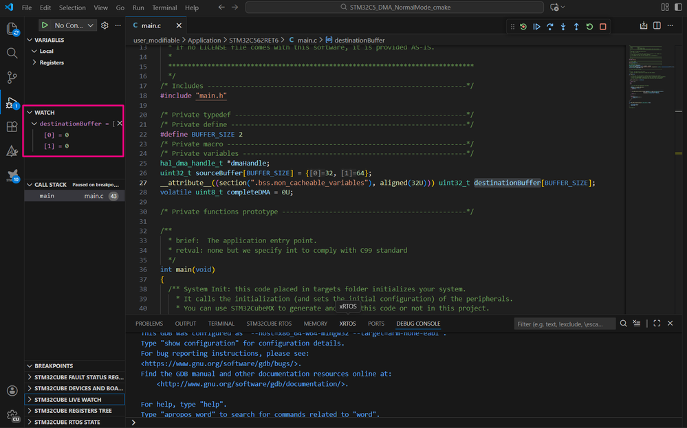

2.2 Validation

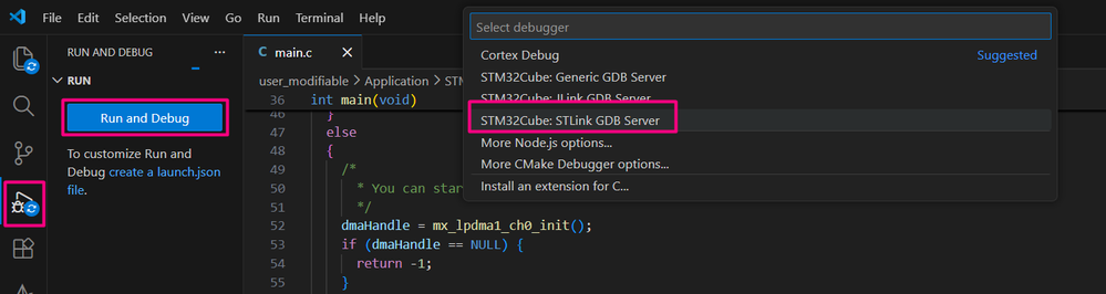

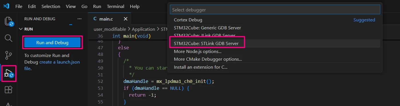

After building the application, select the [Run and Debug] icon. Create a debug session by selecting the [STLINK GDB Server] option.

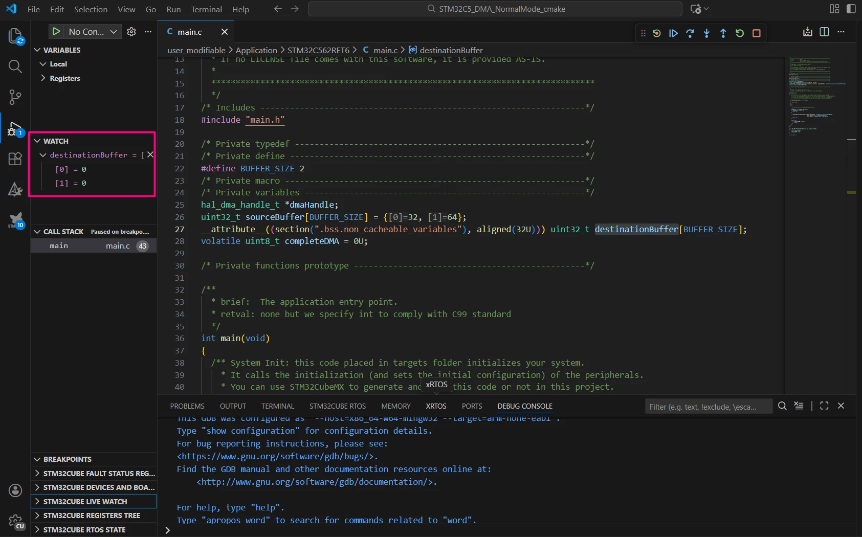

At the start of execution, the destination buffer contains zeros. Use the Watch feature in Visual Studio Code’s "Run and Debug" tab to monitor variable values in real time..

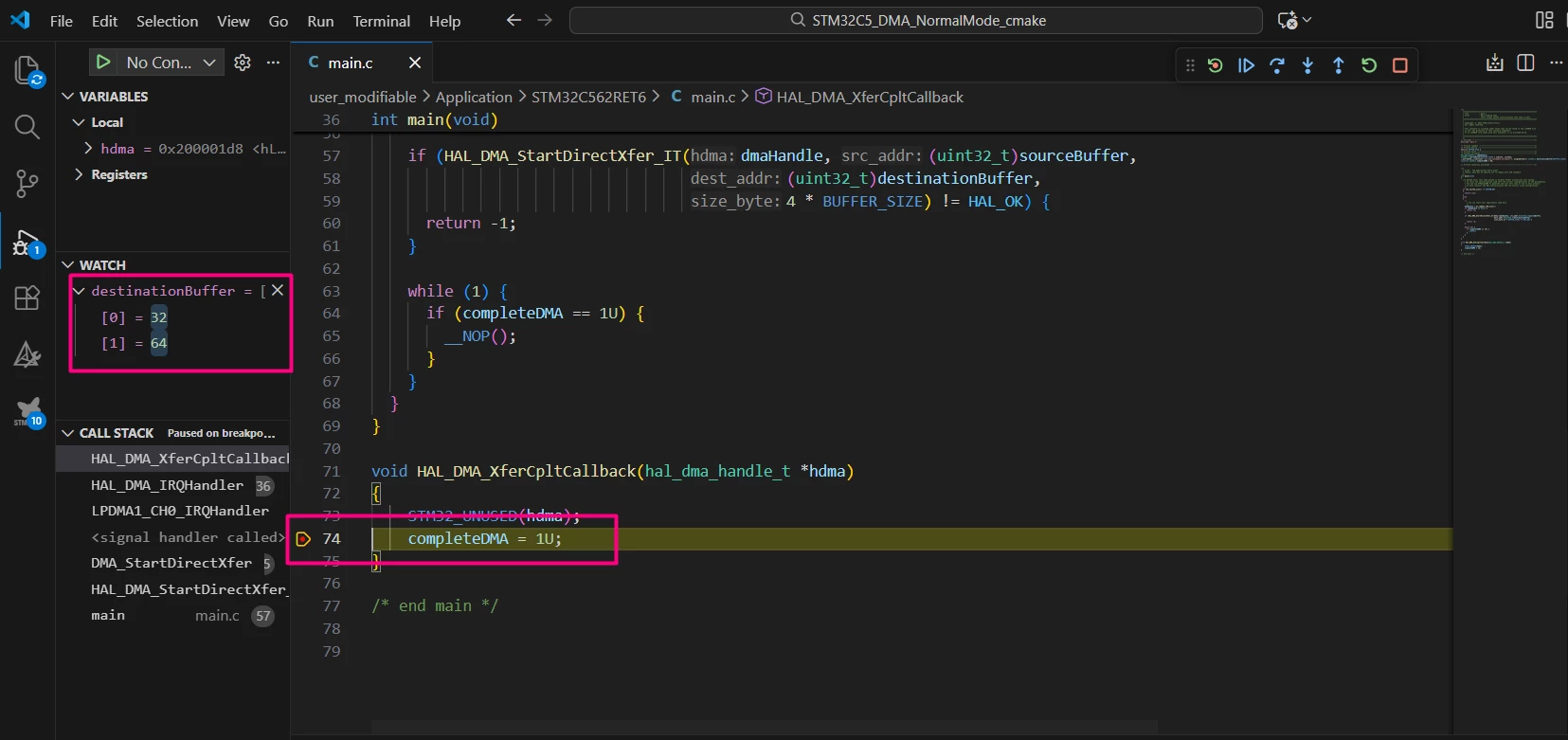

Add a breakpoint in the DMA callback and, after running the program, the DMA transfer complete callback function is called, indicating that the data transfer finished successfully.
By observing the Watch window, verify that the source buffer’s contents were copied to the destination buffer.
