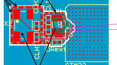

5. Layout considerations
Despite the best values for the capacitors and the crystal, stable operation over the entire voltage and temperature range can be difficult if a suitable layout has not been developed. It is therefore highly recommended to work through the important notes in AN2867, section 7, in order to achieve the desired result.
The following image shows figure 14 of AN2867 as an example, in which the pins to which the HSE and LSE crystals that are connected, are marked with green, orange and pink circles. For better clarification, the ballout from the datasheet is also shown on the right, in which the relevant pins are marked.
What is important here is the realization of the 'trough'-shaped shielding of both HSE crystal and LSE crystal. Each of the crystals has:
  • its own, light blue GND 'base plate', which is separated from the other GND (white dividing line).
  • An additional red GND 'wall' around the crystal and its load capacitors on its assembly layer with several vias to the respective GND 'base plate' of the crystal.
  • A separate GND connection of its GND 'base plate' to the nearest VSS pin, possibly separate from the other VSS, as shown in AN2867, Figure 15

Oct 14, 2025 10:42 PM UTC
What are these two vias (circled in green) for? are they connected to the traces that goes to PC14 or PC15 somehow? They don't look like they are connected to the crystal associated local ground plane.
Peter BENSCH
Jan 8, 2026 8:41 AM UTC
@cpal The example shows the ballout of an STM32F722 in UFBGA176. The green and orange markings are only used to highlight the function so that the assignment to PC14 and PC15 can be immediately recognised. PC14 and PC15 have nothing to do with GND in this device, but rather the functions OSC32_IN and OSC32_OUT.
