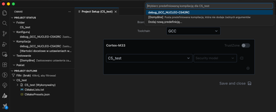

In a project generated in STM32CubeMX2 and imported into VS Code, I do not have the Release compilation option. There is only debug.
B.Montanari
Hi @TDrzy this is the expected behavior, STM32CubeMX2 has removed the release variant as part of the default creation. Only debug is automatically created. You can create the release or any variants, but I understand this can be a bit time consuming, so I'm working on expanding the knowledge base documentation with an article that guides the users on how to create build variants and release as well.

TDrzy
But this makes absolutely no sense. Where did this idea come from? This solution is impractical and only wastes my agent Ai's tokens.
B.Montanari
Hi @TDrzy , point taken. I'll suggest bringing back the release build as part of the default generation. I appreciate your feedback
