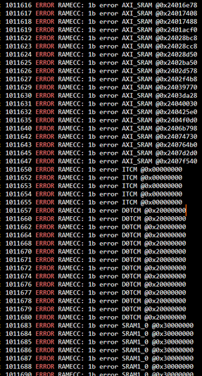

andy_long
Hi @Christophe VRIGNAUD ,
  1. I use STM32H743 and I get M3FAR (RAMECC1) as 0x00003B22. From the datasheet, I understand that the area is DTCM-RAM and I believe the word size is 32-bit.  0x20000000 + 0x3B22 * 4 = 0x2000 EC88. Is this correct ?
  2. How is register RAMECC monitor x failing ECC error code register (RAMECC_MxFECR) useful ?
  3. In an ideal scenario, what should be the fw's action if it detects a double ecc error ?

theHolgi
That does not really work out. I got the following notification (on STM32H753AII):
RAMECC1_M1SR (0x52009044) = 3 (Single and double ECC error)
OK, so this is D1 monitor 2 which belongs to ITCM. Should be a 64-bit bus.
RAMECC1_M1FAR (0x52009044) = 0x3ffd
RAMECC1_M1FDRL (0x52009048) = 0x152f2fef
RAMECC1_M1FDRH (0x52009044) = 0xa9ebe8f8
ITCM base address is 0x00000000.
Failing address is supposed to be 0x00000000 + (0x3ffd * 8 ) = 0x01ffe8.
There is nothing mapped to this address; naively writing the data there results in HardFault.
Shall I mask the address register first to a few lower bits? (Since the maximum size is 64k, and scaling factor is 8, only the lower 13 bits could possibly be set for a valid address.)
Indeed, if I just mask the FAR content like described, I get 0x1ffd to work with which results in memory address 0x0FFE8. The content there in the Memory monitor matches the provided Data Register content.
Is it safe to just mask it like this? Are the FAR higher bits don't care or do they carry additional information?

theHolgi
@KORourke Now I know what the "interleaved" means.
For DTCM, it's not that the two RAM blocks are put one after another, like it is the case for D2 SRAM.
They are interwoven, i.e. we have a 64-bit bus but accessing two 32-bit units of RAM (of 64 kB = 16 kWords each) simultaneously. So for address calculation you multiply the FAR content by 8, but being a 32-bit monitor, each unit will only provide you data in the FDRL register.
DTCM ramRAMECC1_Monitor3
(0x52009060)
DTCM ramRAMECC1_Monitor4
(0x52009080)
0x20000000FAR == 00x20000004FAR == 0
0x20000008FAR == 10x2000000AFAR == 1
0x20000010FAR == 20x20000014FAR == 2
My complete RAM ECC handler now looks like this.
I added the backup SRAM for a complete example (i.e. I did not test it); adjust to your needs.
#define NUMBER_OF_ECC_MONITORS 11
static struct
RAMECC_MonitorTypeDef* monitor;
uint32_t ram_base;
uint16_t mask;
} const RAMECC_Instances[NUMBER_OF_ECC_MONITORS] = {
{RAMECC1_Monitor1, D1_AXISRAM_BASE, 0xffff}, /** RAMECC1 M1 : AXI SRAM (512 kB) */
{RAMECC1_Monitor2, D1_ITCMRAM_BASE, 0x1fff}, /** RAMECC1 M2 : ITCM-RAM (64 kB) */
{RAMECC1_Monitor3, D1_DTCMRAM_BASE, 0x1fff}, /** RAMECC1 M3 : D0TCM-RAM (64 kB) */
{RAMECC1_Monitor4, D1_DTCMRAM_BASE + 4, 0x1fff}, /** RAMECC1 M4 : D1TCM-RAM (64 kB) */
{RAMECC2_Monitor1, D2_AHBSRAM_BASE + 0x00000, 0x3fff}, /** RAMECC2 M1 : SRAM1_0 (64 kB) */
{RAMECC2_Monitor2, D2_AHBSRAM_BASE + 0x10000, 0x3fff}, /** RAMECC2 M2 : SRAM1_1 (64 kB) */
{RAMECC2_Monitor3, D2_AHBSRAM_BASE + 0x20000, 0x3fff}, /** RAMECC2 M3 : SRAM2_0 (64 kB) */
{RAMECC2_Monitor4, D2_AHBSRAM_BASE + 0x30000, 0x3fff}, /** RAMECC2 M4 : SRAM2_1 (64 kB) */
{RAMECC2_Monitor5, D2_AHBSRAM_BASE + 0x40000, 0x1fff}, /** RAMECC2 M5 : SRAM3 (32 kB) */
{RAMECC3_Monitor1, D3_SRAM_BASE, 0x3fff}, /** RAMECC3 M1 : SRAM4 (64 kB) */
{RAMECC3_Monitor2, D3_BKPSRAM_BASE, 0x03ff} /** RAMECC3 M2 : Backup SRAM (4 kB) */
RAMECC_HandleTypeDef hramecc[NUMBER_OF_ECC_MONITORS];
// Direct-access handles for the two DTCM monitors
#define hramecc_d0 (&hramecc[2])
#define hramecc_d1 (&hramecc[3])
* @brief RAMECC Initialization Function
void MX_RAMECC_Init(void)
for (int n = 0; n < NUMBER_OF_ECC_MONITORS; ++n)
hramecc[n].Instance = RAMECC_Instances[n].monitor;
if (HAL_RAMECC_Init(&hramecc[n]) != HAL_OK)
Error_Handler();
// Be notified about all errors
HAL_RAMECC_StartMonitor(&hramecc[n]);
HAL_RAMECC_EnableNotification(&hramecc[n], RAMECC_IT_MONITOR_ALL);
HAL_RAMECC_EnableNotification(&hramecc[n], RAMECC_IT_GLOBAL_ALL);
HAL_NVIC_SetPriority(ECC_IRQn, 1, 0);
HAL_NVIC_EnableIRQ(ECC_IRQn);
/* ECC interrupt handler */
void __USED ECC_IRQHandler(void)
RAMECC_HandleTypeDef* handle;
handle = &hramecc[n];
if (handle->Instance->SR != 0) // Find out which handler fired
// All RAMECC1 busses are 64 bit; all others are 32 bit
bool is_64bit = ((uint32_t)handle->Instance & ~0xff) == RAMECC1_BASE;
uintptr_t address = HAL_RAMECC_GetFailingAddress(handle) & RAMECC_Instances[n].mask;
address = RAMECC_Instances[n].ram_base + (address << (is_64bit ? 3 : 2));
if (HAL_RAMECC_IsECCDoubleErrorDetected(handle))
// Handle Non-correctable ECC Error; e.g. reset
if ((handle == hramecc_d0) || (handle == hramecc_d1))
// Making an incomplete read on the failed RAM makes the monitor freak out completely.
if ((hramecc_d0->Instance->SR != 0) && (hramecc_d1->Instance->SR != 0) && (hramecc_d0->Instance->FAR == hramecc_d1->Instance->FAR))

ztliu722
     We had a chance to put STM32H743 under proton single event test, using ~200MeV proton beam.
Because there is NO official documentation on how to "write back the corrected data" and offering a code example, we basically adopt the code of @theHolgi in the previous reply. We read the whole RAM except for ETMRAM, and logout the the falling address if callback triggers. In the callback, data writeback using the data contained in the RAMECC_MxFDRL/H (we suppose it is the CORRECTED data to writeback, even though it is called falling data register).
   We have observed something really bizzare, a typical example is here:
Basically, AXI RAMECC works as expeced. However, for other RAMs, it always report the first address as failing address. Moreover, in the main loop we also check if the RAM is the same as the predefined data, in case RAMECC fails to trigger. Amazingly, the software RAM check only found two times of dismatch during the whole test.
To sum up, if the RAMECC is working properly, it shows that except AXI RAM, all other SRAMs only fail at the initial address, even though it triggers many multiple times all at once. This is something unbelievable. We would like someone to offer a deeper explanation for this.
