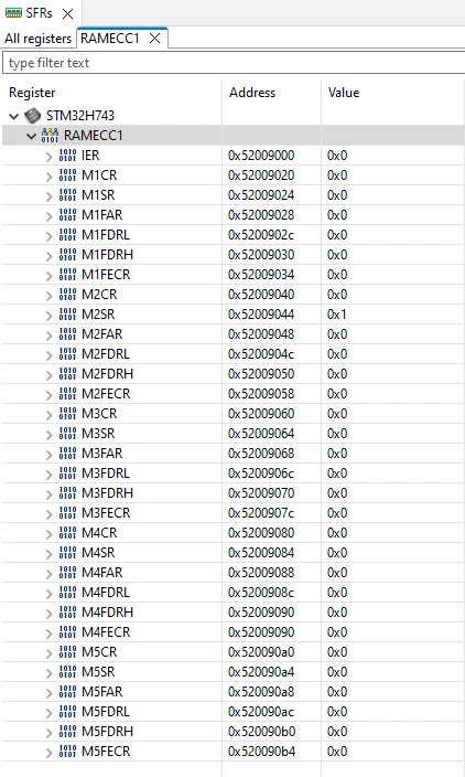

Christophe VRIGNAUD
July 12, 2024
Hi @theHolgi
From which IDE does this screenshot come from? And which version of the tool? On which OS?
Which debugger do you use? (I've found a picture of STM32CubeIDE on MacOS with JLink displaying the SFRs in the memory view: from this I would guess that you are using JLink, right?)
I don't have this view with STM32CubeIDE version 1.16.0 and STLink-V3 debugger. I have a separate SFR registers view as shown in the picture below.
2024-07-12 19_02_02-.png There is no RAMECC_M0xx registers; it starts with RAMECC_M1xx for monitor 1.
It seems there is a shift in your view, with the values of monitor 1 displayed with the addresses of monitor 2.
Moreover, the RAMECC_M1FDRL = 0xA3837F0E. In memory, the value at @0x0000FCE0 is 0xA3837F1E, which is a bit different.
Have you verified that you don't find the content of the FDRL and FDRH registers in AXI SRAM?

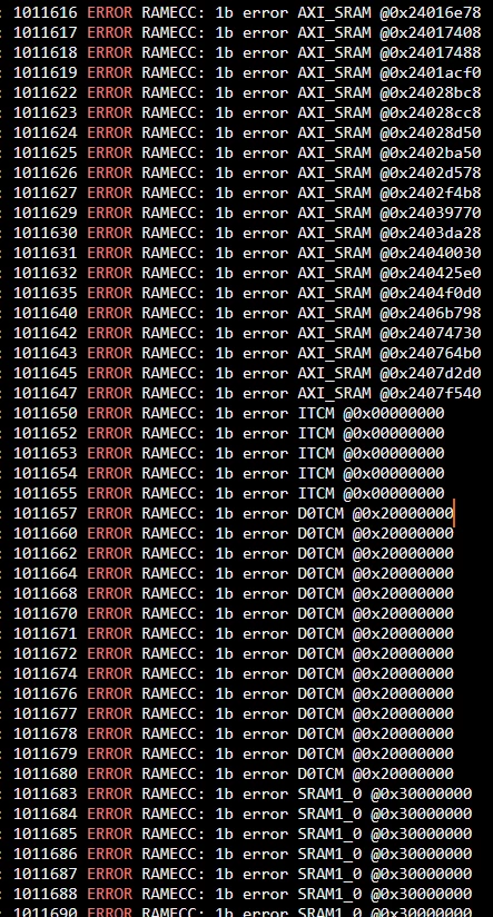

     We had a chance to put STM32H743 under proton single event test, using ~200MeV proton beam.
Because there is NO official documentation on how to "write back the corrected data" and offering a code example, we basically adopt the code of @theHolgi in the previous reply. We read the whole RAM except for ETMRAM, and logout the the falling address if callback triggers. In the callback, data writeback using the data contained in the RAMECC_MxFDRL/H (we suppose it is the CORRECTED data to writeback, even though it is called falling data register).
   We have observed something really bizzare, a typical example is here:
Basically, AXI RAMECC works as expeced. However, for other RAMs, it always report the first address as failing address. Moreover, in the main loop we also check if the RAM is the same as the predefined data, in case RAMECC fails to trigger. Amazingly, the software RAM check only found two times of dismatch during the whole test.
To sum up, if the RAMECC is working properly, it shows that except AXI RAM, all other SRAMs only fail at the initial address, even though it triggers many multiple times all at once. This is something unbelievable. We would like someone to offer a deeper explanation for this.
