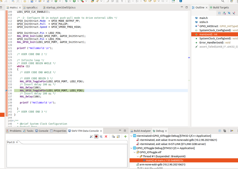

I trying to debug on nucleo-WL55 with serial wire debug via SWO.
I have enable "Serial Wire Viewer (SWV)" in debug config, and add SWV ITM Data console (Config 0).
Even add this code :
int _write(int file, char *ptr, int len)
  /* Implement your write code here, this is used by puts and printf for example */
  int i=0;
  for(i=0 ; i<len ; i++)
    ITM_SendChar((*ptr++));
  return len;
With this line : printf("HelloWorld");
Did you know why it doesn't work? Is that possible to have serial wire on WL-55 ? I have all jumper on JP8 as we receive the nucleo-WL55.

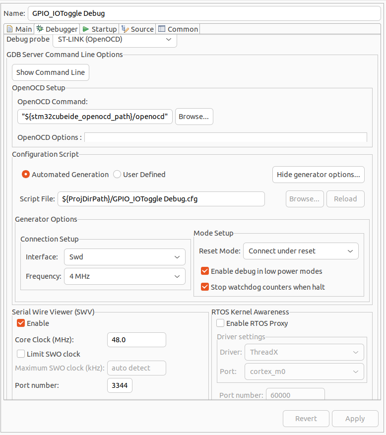

My config :

your configuration is 100% correct just you could change something in your function could you please add a newline : printf("HelloWorld") >>> printf ("HelloWorld \n").
Now you can see your function in SWV Data Console.
The newline will flush the stdout buffer which is not done automatically. This is why you did not see the message.

But it still don't work. I can't see anything on SWV ITM Data console. I have also try to add "Trace event in SWV ITM Data console, but nothing.
I'm on linux Ubuntu OS/Version: 1.11.0 IDECube, connected by USB on nucleo board.

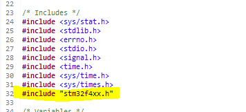

OK! now go to syscalls.c (found under core >>>Src) and make those changes:
  • Under /* Includes */: add your selector board (#include "stm32f4xx.h")>>>you must choose the right selector board.
  • Under /* Functions */ :replace ITM_SendChar(*ptr++); instead __io_putchar(*ptr++).

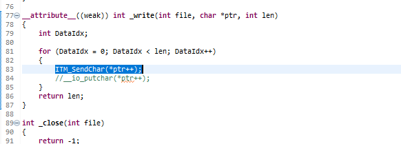

In my case : #include "stm32wlxx.h"
__attribute__((weak)) int _write(int file, char *ptr, int len)
	int DataIdx;
	for (DataIdx = 0; DataIdx < len; DataIdx++)
		//__io_putchar(*ptr++);
	return len;
But still nothing :grinning_face_with_sweat: :loudly_crying_face:

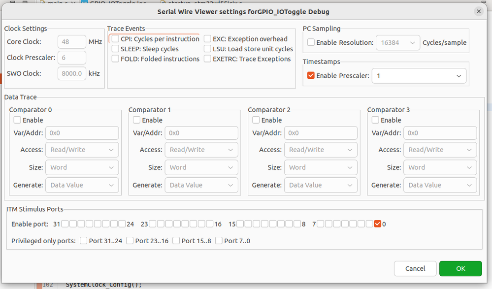

Before running you click on the Start/Stop trace (red button) Showen bellow?

LEdou.1
Yes as you can see red button is "ON" but still nothing on Port 0 !
