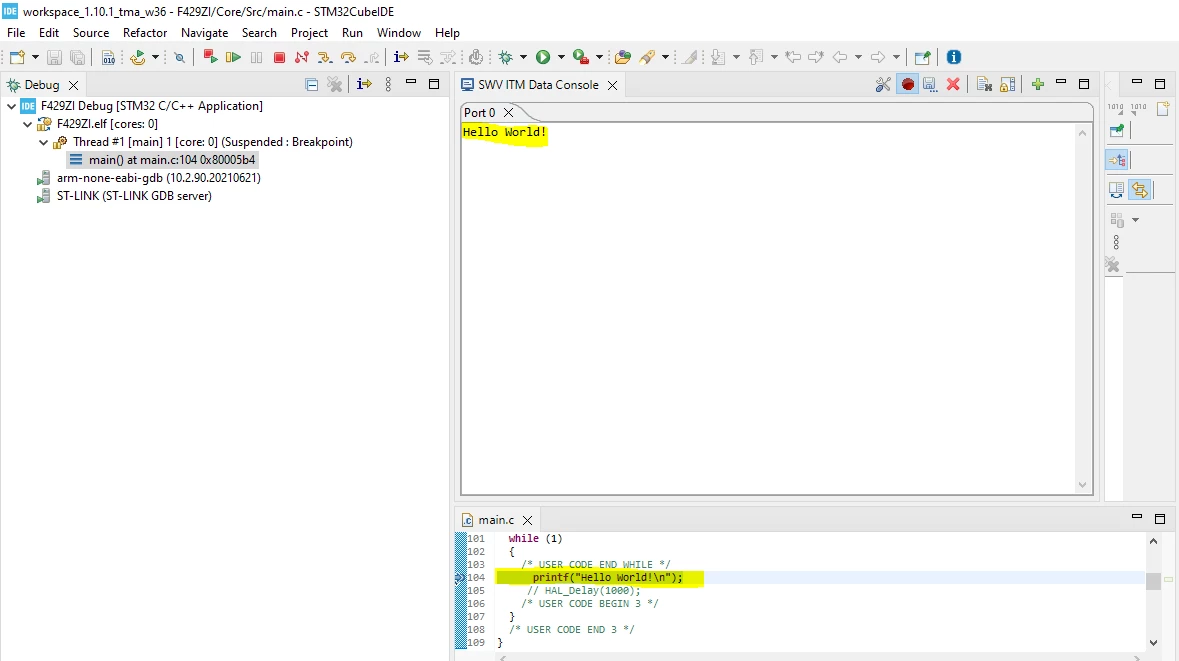

Wijeden RHIMI
Dec 15, 2022 2:42 PM UTC
You could see this example in the screenshot bellow using CubeIDE 1.10.1 and NUCLEO-F429ZI.
Wijeden,
