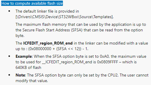

Hi again,
I have another potential cause for your problem.
Still in the file STM32Cube_FW_WB_V1.8.0/Projects/STM32WB_Copro_Wireless_Binaries/STM32WB5x/Release_Notes.html,
It is said that:
So can you check the SFSA value for your product ? It should be 0x57 (BLE stack starting address). Then you can't set an emulated EEPROM after the address 0x08057000 because this area can't be used by the user application anymore (only CPU2 can change SFSA, user cannot).
Thanks.
Adam
‎2020-08-21 5:00 AM
Seems the screenshot did not pass...
To complete:
...It is said that:
