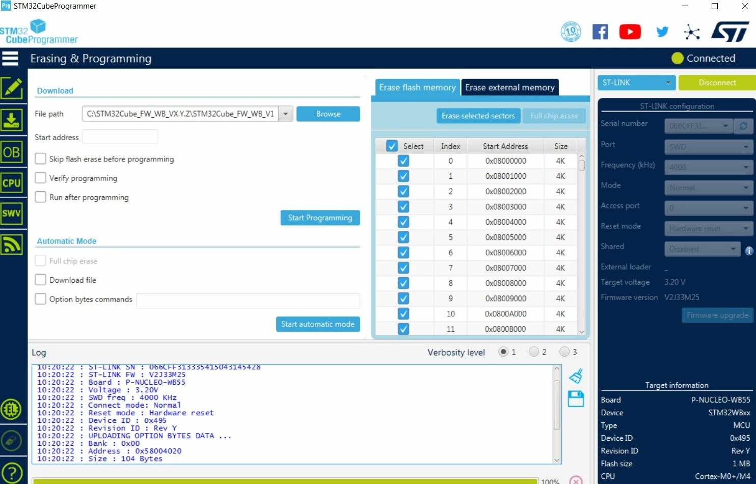

>is the FLASH Mass erase still necessary?
No. It should not be necessary but it is a kind of sanity check as the FUS is looking for some specific key code in flash memory to udentify the start of the new FW to upgrade, It is more secure to clean the user area​ (up to SFSA).

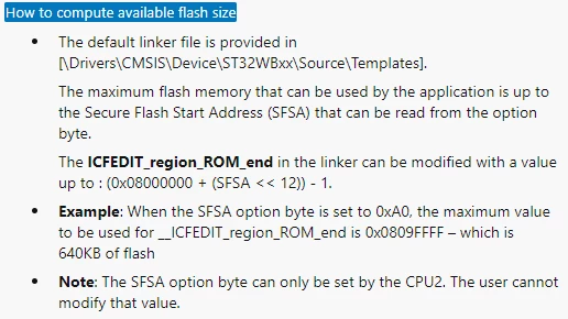

Still in the file STM32Cube_FW_WB_V1.8.0/Projects/STM32WB_Copro_Wireless_Binaries/STM32WB5x/Release_Notes.html,
It is said that:
So can you check the SFSA value for your product ? It should be 0x57 (BLE stack starting address). Then you can't set an emulated EEPROM after the address 0x08057000 because this area can't be used by the user application anymore (only CPU2 can change SFSA, user cannot).
Thanks.

Seems the screenshot did not pass...
To complete:
...It is said that:
