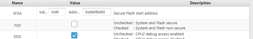

Strange! Could you give us the value for the SFSA and SBRV option bytes?

1) Could you give us the value for the SFSA and SBRV option bytes?
A: i can find SFSA but SBRV not there in that list

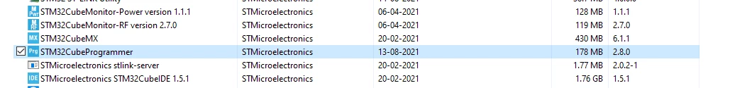

3) Could you move to CubeProgrammer 2.8 and read the FUS value with this version?
A: yes i am using same version

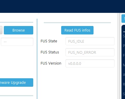

4) You may have to press the "READ FUS version" button twice to get the version
A: 0693W00000Dq66pQAB.png​

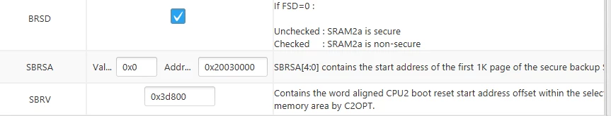

1) So what is the value of SFSA? Still 0xF6?
Note that the SBRV option byte is in the same "secure" window but you may have to scroll the window down a bit to see it appearing.

1) Yes i got the SBRV  value as well as SFSA see*2

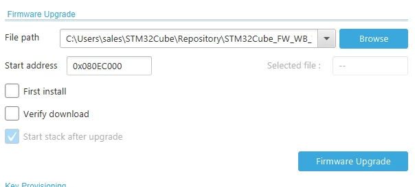

2) No...i am not updating using cmdprompt just i am clicking the firmware upgrade option see *1

For the FUS upgrade , you should uncheck the "Start stack after upgrade" button. I see it seems not active as there is no FW installed but who knows.
SFSA and SBRV option bytes are consistent. The load address is also OK.

Still missing the SBRV value (a consistent SBRV value = 0x3D80). The SBRV option byte is the last one of the security configuration.
