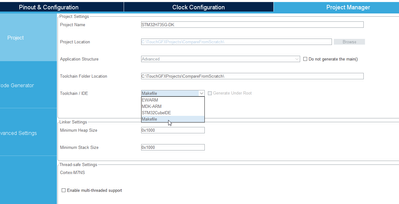

From the png I can read "unsuppoprted toolchain : makefile".
It looks like you select the makefile toolchain in STM32CubeMX when generating code such as below :
If you want to flash your board from Designer, you have to select STM32CubeIDE.
