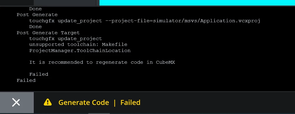

Then i click on "Generate Code" it fails with: Generate Code | Failed.
Unsupported toolchain: Makefile

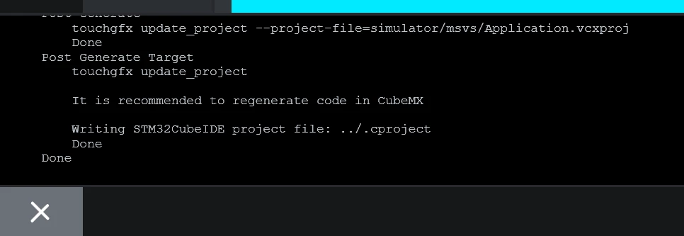

Then i click on "Generate Code" it succeeds with "Generate Code | Done".
Back in CubeIDE i click on "Build Project" and it succeeds.

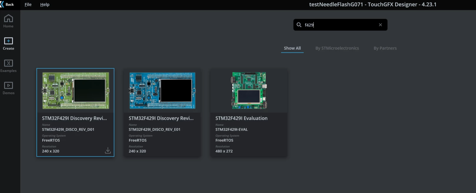

I have created a project from Designer by specifying the board I want to use as STM32F429 and I got a working project.
I must re-iterate, I think your board bring up is the problem here.
You could get inspired (to create your board bring up) by our TBS, the one you get when creating a project from Designer using a specific board such as below:
Simply open Designer, click on "Create" or on "Create new", enter the beginning of the name of your MCU, select your MCU then click on create on the bottom right corner.
From there you will have all the files generated for the specific MCU used on the discovery board (same as you) and for the specific screen used on the discovery board (different than yours).
You can open the ioc file generated and compare it to your ioc file.
Fix the differences and modify it to fit to your screen specifications.
I hope you see the value in this method as it is hard for me to help you on a custom board that I know very little about and that I cannot debug as I don't have it in hand.

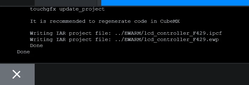

When i choose EWARM Toolchain in CubeMX, Designer can generate code successful:
It works with STM32CubeIDE Toolchain as well:
But it does not work with Makefile as Toolchain selected in CubeIDE:
Do you really think my project board bringup is the problem? I did not write any code so far, it is just what CubeMX generated, with no changes. Your suggested way of selecting an existing project worked, i think it chooses somethink else but not Makefile as Toolchain internally.

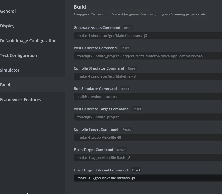

#6 This Option is disabled because under Config -> Build in TouchGFX Designer the Compile Target Command is empty line so this is probably the reason why compiling is not possible under designer.
So usually the command in this Line is something like "make -f ../gcc/Makefile".
But the only Makefiles in the while file tree are:
./Src/simulator/gcc/Makefile
./Src/generated/simulator/gcc/Makefile
So this is only for simulator, not for real target.
Should Designer create this Makefile for target compiling?

You are right, if the "Compile Target Command" is not specified, you won't be able to compile (hence the bottom right button greyed out).
Here are the commands from one of my projects :
You will have to create a Makefile. You can take inspiration from the one generated when creating a STM32F429 project directly from Designer.
