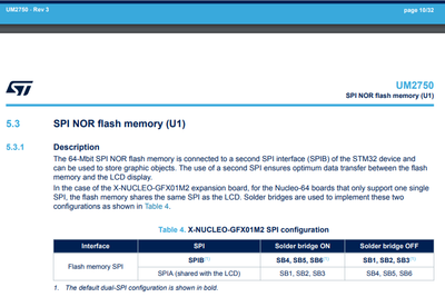

Did you look at the examples on the X-NUCLEO-GFX01M2 Product Page:
https://www.st.com/en/evaluation-tools/x-nucleo-gfx01m2.html#tools-software
PS:
The SPI NOR Flash on the X-NUCLEO-GFX01M2 is documented in the User Guide - starting on page 11:
https://www.st.com/resource/en/user_manual/um2750-spi-display-expansion-boards-for-stm32-nucleo64-stmicroelectronics.pdf#page=11

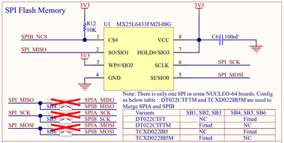

See also the schematics:
https://www.st.com/en/evaluation-tools/x-nucleo-gfx01m2.html#cad-resources
From there, you can find details of the memory chip:
https://www.macronix.com/en-us/products/NOR-Flash/Serial-NOR-Flash/Pages/spec.aspx?p=MX25L6433F&m=Serial%20NOR%20Flash&n=PM2130&epn=MX25L6433FM2I-08Q
