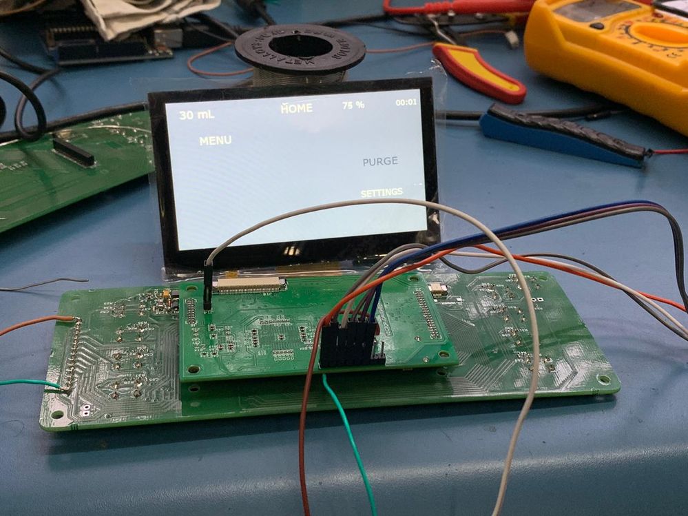

We have developed a custom STM32 board using STM32F746G controller, with the hardware design based on STM32F746G-DISCO EVAL board.
We are using TouchGFX for developing graphics.
The debug interface we are using is JTAG, and the debugger we are using is STLINK-V3SET
We are using ST-LINK Utility for flashing the hex file.

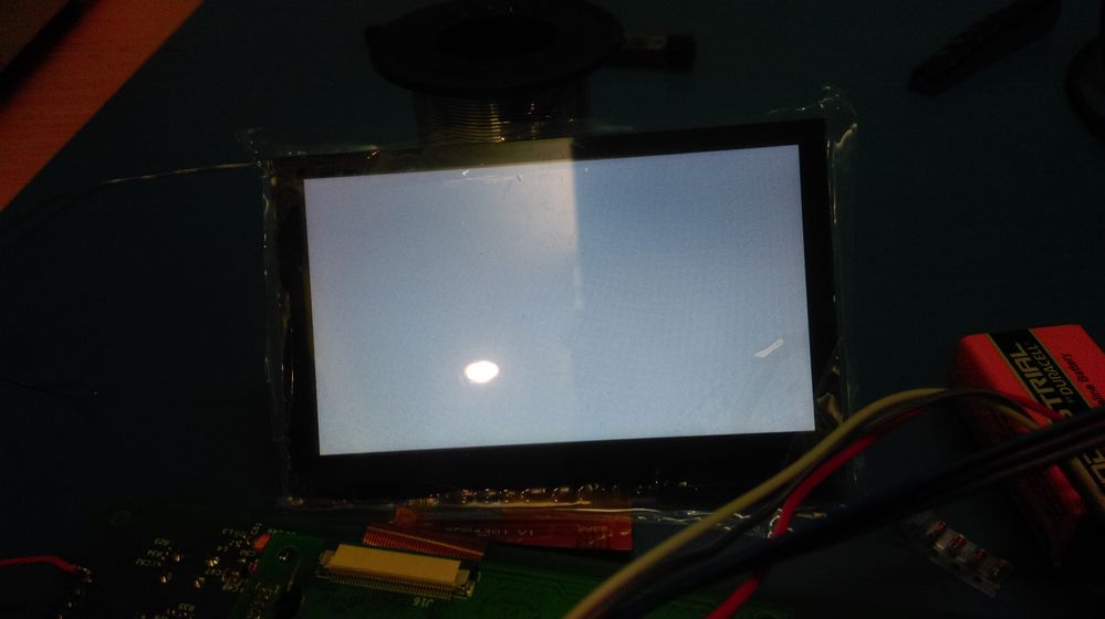

The device gets programmed but the graphics displayed are incomplete.
The texts with colour variation are seen but widgets such as buttons and image are not seen. Also, wildcard text changes are visible.
Our pin mapping are exactly same as per EVAL board for QSPI, SDRAM, LCD TFT, etc
Please refer below images, the image needs to be displayed but the screen shows blank.
I understand graphical assets get normally stored in QSPI memory and based on the log of ST Link Utility the program is not getting written at QSPI memory locations at all due to which we are able to produce text content but not able to show graphics as programmed in TouchGFX.
We expect your expert advice to understand cause of this issue and solve this.

As @HP​ states - Your texts may be in internal flash (since they are displayed), but your image entries in the image database in touchgfx may be pointing to memory in external flash (which isn't programmed properly).
Check your linker script to find out where assets are placed. I'm not even sure how you created this project, so we'll see.
You must load your external flashloader manually in ST-Link/STCubeProgrammer. Depending on how your QSPI chip is connected you may have to write your own - Since you state that it is pin compatible you should be able to use an existing one.

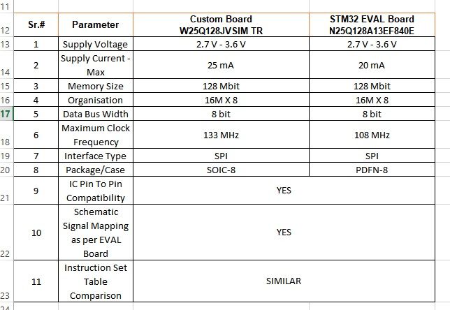

Also, another point is that since the EVAL board QSPI chip is obsolete, we used it's alternative which is having almost same specifcations and also, same pin to pin compatibility.
Please refer below datasheets of the QSPI chips
1) EVAL Board QSPI chip - https://www.mouser.in/datasheet/2/671/n25q_128mb_3v_65nm-1283709.pdf
2) Custom board QSPI chip - https://www.mouser.in/datasheet/2/949/w25q128jv_dtr_revc_03272018_plus-1489858.pdf

2) If I am not able to use the same external loader even though the QSPI chip is connected to MCU as per EVAL board (except that they are of different makes but same specs and pin to pin compatibility), How do I make a custom external loader?
Please refer the below image for the comparison of QSPI chips used in custom board and EVAL board.
Looking forward to your advice.
