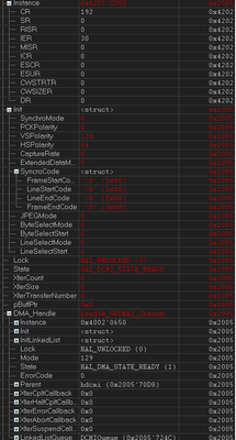

I've been struggling trying to get an Image from a Image sensor over DCMI via the GPDMA on an STM32U575.
The image sensor has a resolution of 752*480, though I only want to capture 420*420, which I've configured on the sensor to output. I've also configured it to output a B&W image meaning I only get one byte per pixel.
I've used the DCMI_ContinousCap_EmbeddedSychMode example as the basis for my code, though I'm not using an omnivision sensor so I've swapped out the configuration for one required for my image sensor. However, for the most part, I have not modified the GPDMA or linked list settings from this example, just the I2C comms (swapped to SPI) and DCMI to external synchro, and DCMI polarities to match my image sensors output.
when I try to pull a full image in one DMA transfer, I get an overflow error after only receiving half the image (88200 bytes). When I make the image size 360*360 I get the full image just fine (129600 bytes).
I did try splitting this into 3 requests of 420*140, after receiving the first of these 3 requests the DCMI remains in the busy state and never returns to a ready state, if I force it into the ready state in the line callback, it goes into the ready state but then fails to start on the next HAL_DCMI_Start_DMA call.
I also tried adding additional nodes to my linked list, the original example had 2 set up, I've attempted adding 2 additional nodes with the same settings and this didn't work either.
Also I am never getting a DCMI_FLAG_FRAMERI interrupt, even if I set my image size to 16*16 I get all 256 bytes but I don't receive an interrupt, instead I get a line interrupt. I can see my VSYNC line going high from my image sensor.
I am curious as to what the STM treats as "active high" in the DCMI parameter settings related to synchronization, does "active" mean in the process of receiving data or syncing at the end of a given line or frame. The reason I'm asking is that if it's active in the state that it is receiving data (pixels being output), I'm getting nothing in terms of data, only when i set these to the opposite of what my sensors datasheet states do I receive any data, this datasheet explicitly states that the LEN and FEN (vsync and hsync equivalent) are active low (0 means that pixels are being output).

Best answer by JMarshall123
I think my problem is related to alignment, when I pass the data from the DMA into a 32 bit buffer rather than an 8 bit one, the data goes through just fine. I made the assumption that passing in the memory location by pointer meant that it didn't matter what it was filling into. I am able to create a union allowing me to fill in a 32 bit buffer and use individual bytes, so this solution works for me.

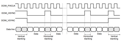

Regarding the meaning of "active high", for example, if VSYNC is programmed active high:
• When VSYNC is low, the data is valid.
• When VSYNC is high, the data is not valid (vertical blanking)
The below figure shows an example of data transfer when DCMI_VSYNC and DCMI_HSYNC are active high, and when the capture edge for DCMI_PIXCLK is the rising edge.
For more information, I advise you to take a look to AN5020 and precisely 5.4.1 Hardware (or external) synchronization section.

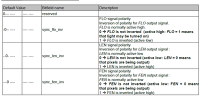

This makes sense you've confirmed my suspision that ST is refering to the "active" state as the state where data is not valid or point of line sync, in which blanking data is sent. This is the opposite to what my sensors datasheet is refering to as the "active" state. See image from my imagers datasheet below where LEN is HSYNC and FEN is VSYNC:
It's not that I was inverting the syncronization, what is referred to in my sensors datasheet as active low or active high is flipped compared to how ST describe it. To be honest I think STs terminology is better, for the most part I think its what is considered standard, though I am not the only one that realised this terminology is confusing See this post.

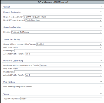

I've managed to confirm that there isnt an issue with my frame interrupt at all though, just that the largest dma image I can request is 360x360, I've confirmed my data width is word and not half word. I was under the assumption that the largest DMA transfer was 4*65535 in bytes when using word as the datawidth, is this correct? And if so why would I getting overflow errors when requesting more than 2*65535? Is the configuration of the gpdma and linked lists in the DCMI_ContinousCap_EmbeddedSychMode example suitable for receiving a 420*420 image (176400 bytes)?

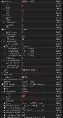

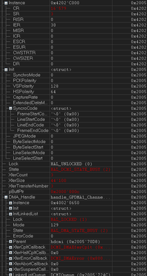

February 21, 2024
Just a quick update, turns out __HAL_DCMI_DISABLE_IT(hdcmi, DCMI_IT_FRAME) was being called prematurely in the hal dcmi source fill, only when I regenerated by code again did I notice this. I'm guessing I just dragged it in my IDE by mistake at some point. I am now getting frame interrupts but I am still not able to receive any more than a 360 x 360 image, without an overflow error, this limitation appears to be 2*65535 as, in my dcma structure, when XferCount is 2 after requesting, everything is fine but as soon as this increases to XferCount is 3, I get overflow issues. This is why I assumed I required additional linked list items as the example only had 2 nodes and I wasn't sure how the dma would handle 3 transfers over 2 nodes. I also noticed the example didnt have the Source address, Destination address and data size configured for either node, but I assumed that this is because calling HAL_DCMI_Start_DMA configures these values automatically using its input parameters. Is this correct?
