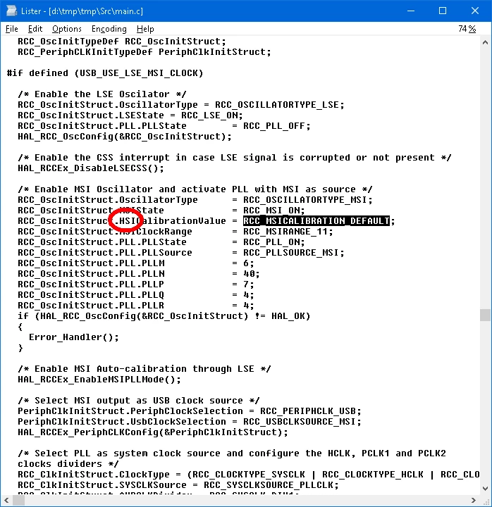

    In [STM32Cube_FW_L4_V1.5.0]\Projects\STM32L476G_EVAL\Applications\USB_Device\CDC_Standalone\Src\main.c I see this:
    Can't this be the at root of the problem?

    waclawek.jan
    Apr 6, 2017 2:48 PM UTC
    Posted on April 06, 2017 at 14:48
    However, I am not sure that it is the root cause of the issue as the reset value for MSITRIM bits is 0.
    RCC_OscInitStruct is a local variable in  that function, and I don't see any explicit initializer for the entire struct. It means that the MSICalibrationValue field of it has an undefined value, whatever was in the piece of stack where that variable is located.
    As this function is called early in the program, it is quite likely it contains an 'untouched' value from the SRAM. Upon powerup, SRAM cells tend to flip to a certain position depending on miniscule manufacturing process variations, which might explain why some boards systematically work and other don't. There of course might be other explanations, too - undefined is hard to define ;)
    HAL_RCC_OscConfig() then subsequently uses this 'random' value to fill in the RCC_ICSCR.MSITRIM field.

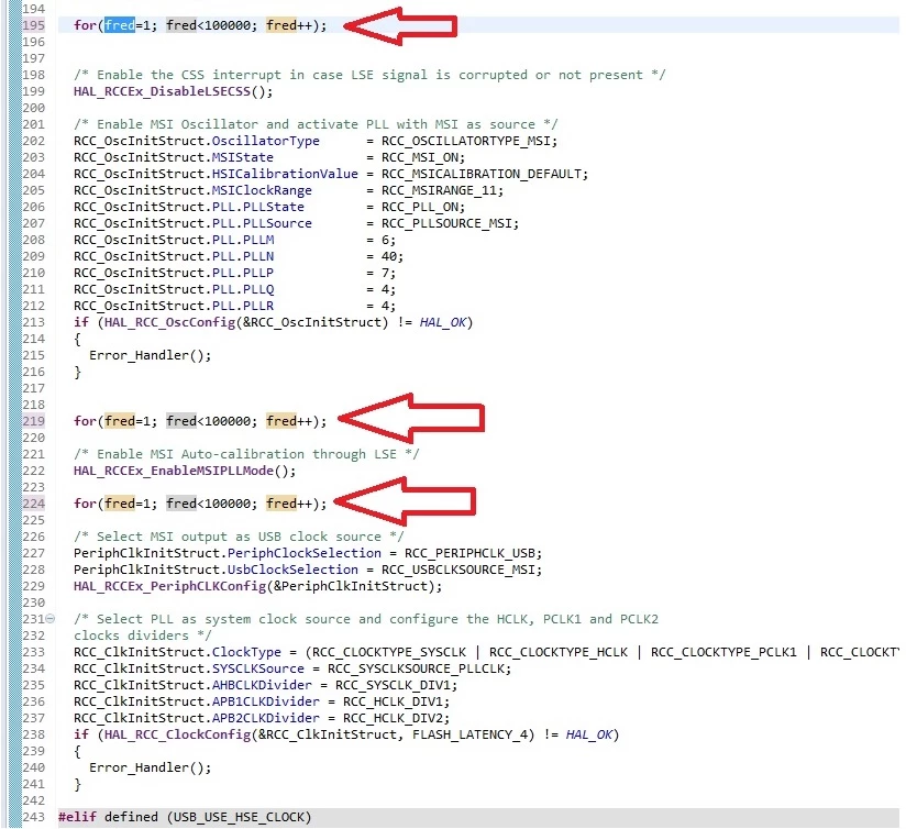

    Add VAR in main
    uint32_t fred = 0 ;
    Then -
    Add those lines on my Nucleo that misbehaves -   48.005MHZ out MCO pin for MSI.
    Comment these out -  TURBO! 57.488MHZ
    Repeat 5 times.
    Same results. LINES IN = GOOD - LINES OUT = BAD.
     I let my contacts know.
    And - Yeah maybe just ONE of those lines might do it.
    More tomorrow I'm sure.   (I need to grab one or all of the production Duds...)
    waclawek.jan
    waclawek.janBest answer
    Apr 7, 2017 12:57 AM UTC
    Posted on April 07, 2017 at 00:57
    Omit Fred, fix the bug I told about above (instead HSICalibrationValue should be MSICalibrationValue).
