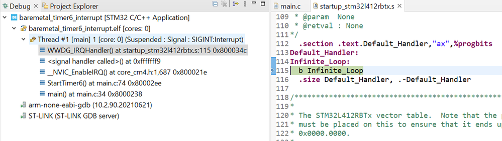

I am using STM32L412 microcontroller and doing baremetal programming for timer interrupt. I am using Timer 6 and base clock of 4MHZ is used as HCLK. However my interrupt is not firing below mentioning my code. count variable is also not updating
int main(void)
LedConfig();
StartTimer6();
/* Loop forever */
while(1)
count=1;
void LedConfig(void)
/*Enable Clock for Port B. */
RCC->AHB2ENR |= (1U<<1);
/*Configure GPIOB_13 as general purpose output*/
GPIOB->MODER |= (1U<<26);
GPIOB->MODER &= ~(1U<<27);
void StartTimer6(void)
RCC->APB1ENR1 |= (1U<<4);
TIM6->PSC = 1000;
TIM6->ARR = 4000;
TIM6->EGR |= (1U<<0);
TIM6->DIER |= (1U<<0);
TIM6->CR1 |= (1U<<0);
NVIC_EnableIRQ(TIM6_IRQn);
void TIM6_IRQHandler(void)
if(TIM6->SR & (1U<<0))
GPIOB->ODR ^= (1U<<13);
TIM6->SR &= ~(1U<<0);

2023-02-14 2:41 AM
Thanks @KnarfB as you said IRQ handler was different the actual one is TIM6_DACUNDER_IRQHandler. After I changed the handler name the code started working

2023-02-13 10:26 PM
When I tried with Timer 2 this code is working as expected, LED blinks at 1 second interval. Is the Timer 6 of STM32L412 has any additional configuration to made in order to work like this.
This is what I get when I debug.
2023-02-13 11:24 PM
This happens when the specific IRQ handler is not implemented. See the interrupt vector table in the startup code for the proper names. Guess: TIM6_DAC_IRQHandler?
hth
KnarfB
