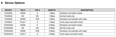

When I select FDCAN mode without BRS, it works without any problems.
When I select with BRS mode.
I set the arbitration phase to 1mbps.
I set the data phase to 8 mbps.
I cannot receive 8Mbps data in BRS mode.
I set the data phase speed to 2Mbps. I can receive data in BRS mode, but I cannot receive data at 8Mbps.
I have 2 reasons for this.
Firstly, the can transceiver may not support this speed.
The can transceiver I use is TCAN334D.
It says up to 1 Mbps in the datasheet, but I was able to get 2Mbps as well.

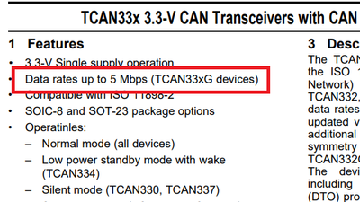

No, the TCAN334D datasheet says that it could reach 5Mb/s:
So that's normal you didn't get it worked at 8Mb/s but worked at 2Mb/s.
Replace the transceiver: example: MCP2561FD or MCP2562FD to reach 8Mb/s.

The speed up to 5Mbps is written for TCAN33..G series, I am using the D series. so it may not support 5Mbps speed..
I can change the transceiver. I can use MCP series, but I am wondering if it can be fixed with the functions written here..

Ok but D suffix was not listed in their table:
Enable the delay compensation but the most important thing is to use a transceiver that can reach 8Mb/s.
And it worked at 2Mb/s because the chip manufacturer has a margin and that could not work for all the conditions.
Hope that answers your question.
