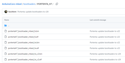

‎2024-04-23 2:40 PM - edited ‎2024-04-23 4:35 PM
I cannot thank you enough for your time!
I grabbed the latest bootloader from GitHub and now my H7 is visible on a COM port! I used the Arduino IDE to write a multiple colored led blink sketch and it worked great. I then wrote that sketch and flashed it via the CubeIDE and it works great!
This is the good bootloader:
portentah7_bootloader_mbed_hs_v2.bin
It has an .elf equivalent but the CubeProgrammer couldn't flash it.
Admittedly, I am not as well versed with the Cube set of tools as I thought I was. So I have a lot of reading and test programs to write.
Again, I really appreciate your time
