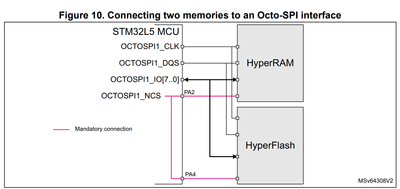

BobaJFETAuthor
December 13, 2024
For example, this is from AN5050. Here it's a single OSPI. I now question if this is possible with quadSPI as well, but I don't see any mention of this type of configuration in AN4760.

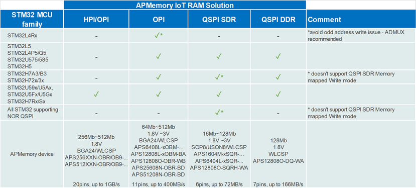

Alex - APMemory
December 13, 2024
I can only agree that checking exact STM32 device and associated supported QPSI or OPI or HPI is first things to do.
When QSPI/OPI/HPI is supported I can only suggest to use it, rather legacy SDRAM, for pin count, power, package options and competitivness benefit. this is even more true with the Hexa interface of STM32H7S/R or STM32U599...
Below is an overview of supported device,  STM32 / IoT RAM crosslist, which may help .
 APMemory IoT RAM Solution
STM32 MCU familyHPI/OPIOPIQSPI SDRQSPI DDRComment
STM32L4Rx-✓*--*avoid odd address write issue - ADMUX recommended
STM32L5
STM32L4P5/Q5
STM32U575/585
STM32H5
STM32H7A3/B3
STM32H72x/3x
-✓** doesn't support QSPI SDR Memory mapped Write mode
STM32U59x/U5Ax, STM32U5Fx/U5Gx
STM32H7Rx/Sx
All STM32 supporting NOR QSPI--✓*-* doesn't support QSPI SDR Memory mapped Write mode
APMemory device256Mb~512Mb
1.8V
BGA24/WLCSP
APS256XXN-OBR/OB9-...
APS512XXN-OBR/OB9-...
64Mb~512Mb
1.8V ~3V
BGA24/WLCSP
APS6408L-xOBM-...
APS12808L-xOBM-BA
APS12808O-OBR-WB
APS25608N-OBR-BD
APS51208N-OBR-BD
16Mb~128Mb
1.8V ~3V
SOP8/USON8/WLCSP
APS1604M-xSQR-…
APS6404L-xSQR-...
APS12808O-SQRH-WA
128Mb
1.8V
WLCSP
APS12808O-DQ-WA
20pins, up to 1GB/s11pins, up to 400MB/s6pins, up to 72MB/s7pins, up to 166MB/s

Hello @BobaJFET ;
Could you please precisely which STM32H7 device are you using?
Is the device supporting one QUADSPI interface? If you have two QUADSPI interfaces available, you can connect each memory with a different QUADSPI interface.
If you want to connect two quad memory using only QUADSPI interface, you can select a different chip select GPIO pins for each memory.
The two memories must be connected to the same QUADSPI instance. The chip select of each memory must be connected to a QUADSPI chip select GPIO. The software should configure the chip to select the GPIO pin for the memory to be accessed by driving the GPIO configuration.
I think the proposed solution2 in this FAQ may help
Thank you.
Kaouthar

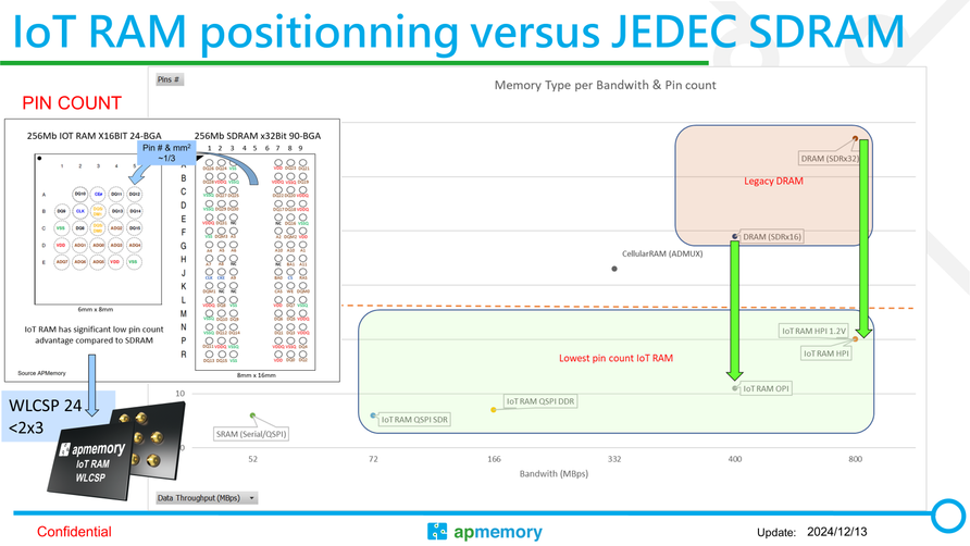

Alex - APMemory
December 13, 2024
Here are STM32H7 option for using low pin count RAM
-STM32H7A3/B3 : Octal DDR (11pins), QSPI DDR(7pins), no QSPI SDR
-STM32H72x/3x : Octal DDR(11pins), QSPI DDR(7pins), no QSPI SDR
-STM32H7Rx/Sx : Hexa DDR(20pins), Octal DDR(11pins), QSPI DDR(7pins), QSPI SDR(6pins). With multiple Memory controller, you can separate Flash and RAM on different bus, upon pin counts
Hope this help your selection
Alex
PS: IoT RAM / SDRAM : Pin count - Performance - package (cost & package cost correlated) overview
