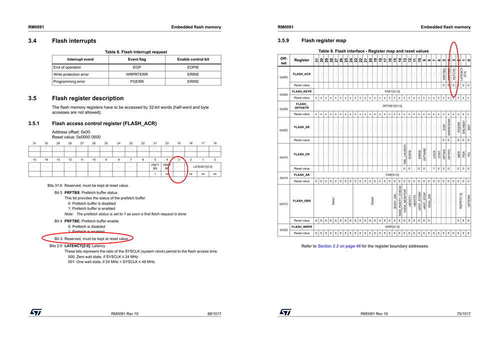

Is there HLFCYA in 'F0 or not?
waclawek.jan
0693W00000aJGEfQAO.pngJW
PS. Also, what exactly is this bit?

Foued_KH
Hello @Community member​ ,
Thank you for reporting this typo.
I will check internally.
Foued
