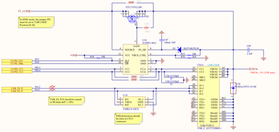

hi Team,
Have configured PA11 and PA12 as USB_DM and USB_DP respectively.
Further , How to configure USB VBUS in STM32H523RETx LQFP64?
Regards,
Deep_Bang
1 reply
September 11, 2024
Hi @Deep_bang
If you are using Type C connector, you can follow the example provided in schematics.
Also, check the following FAQ on Vbus sensing
Management of VBUS sensing for USB device design - STMicroelectronics Community
To give better visibility on the answered topics, please click on "Best answer" on the reply which solved your issue or answered your question.Best regards,FBL
