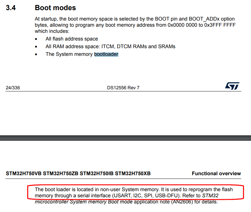

I use a STM32H750 chip and I would like to use the emdedded bootloader with the FDCAN1 interface. AN2606 specifies pins PH13 and PH14 for this version. However, the package I use (STM32H750VBT6 LQFP100) doesn't have these pins exported. Does it mean that there is no FDCAN bootloader option for the 100-pin package?

DBign.1
Ok, thank you very much for your answer.
What does that mean "you can activate the FDCAN bootloader with only by PH13/PH14 pins."?
@DBign.1 Those pins dont exist right?
It means that those are the only pins you can use - you cannot use any other pins.
Which is, presumably, why the datasheet doesn't mention FDCAN as a bootloader option:
https://www.st.com/resource/en/datasheet/stm32h750vb.pdf#page=25
Similarly for the stm32H743ZI:
https://community.st.com/t5/stm32-mcus-products/fdcan-rom-bootloader-pins-for-stm32h743zi/m-p/762443/highlight/true#M270761
if you go look into AN2606 youll find there is supposed to be a canbus bootloader for this mcu
hit me up in https://www.linkedin.com/in/javiermu%C3%B1oz/
Yes, looks like AN2606 makes some sweeping generalisations - which aren't always true.
