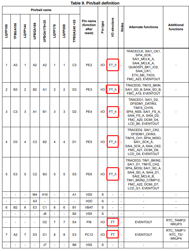

I’m working with an encoder that has a specification of 1024 pulses per revolution (p/r), and it will operate at a maximum speed of 1500 RPM. At this speed, the signal frequency produced by the encoder is approximately 25.6 kHz.
The encoder outputs a 5V signal, while my MCU (the STM32H743VIT6) can only handle a maximum  input voltage of 3.3V. To address this, I plan to use a TXS0108E level shifter to convert the signal from 5V to 3.3V. Currently, I’m using a Blue Pill for testing until my main MCU arrives (the STM32H743VIT6).
I’d like to know if this is a good approach. Is the TXS0108E suitable for this application at the given frequency? Are there any better alternatives or recommendations for interfacing a 5V encoder output with a 3.3V MCU?

@sktech You do not need a level shifter if you connect the encoder to 5V tolerant GPIO (labelled FT). See also this thread, for example or RM0433, section 11.3, fig. 71.

Thank you for your responses. I don't know which pins are 5V tolerant, but let's say that I need to use a logic level converter. Would you recommend this approach? If so, why? How would you suggest I implement it? Btw i have single signal not differential
It is easy to find out which pins are 5V tolerant: find out the pins to which you want to connect the encoder, then find the corresponding connection structure in the data sheet, table 9 in column I/O structure (possible suffixes are explained in table 8).
