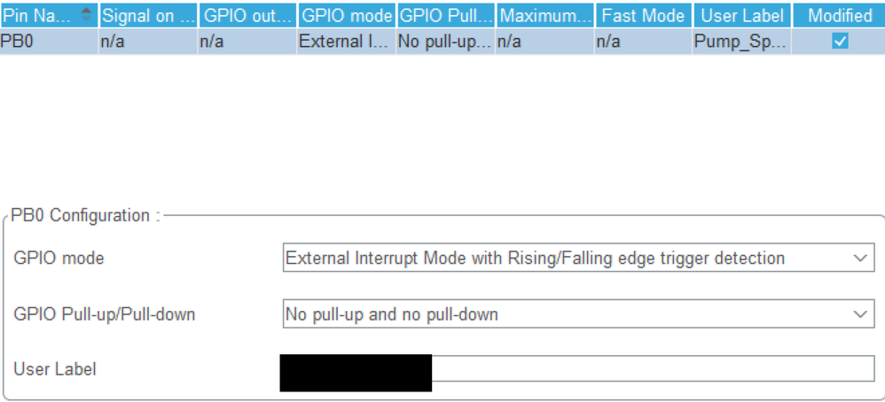

I am interfacing a 5V PWM signal with an STM32F030K6T6 MCU using PB0. According to the datasheet this pin is 5V Tolerant. In the past, regardless of a pin's "tolerance" to 5V I have always used a level shifter to change this 5V signal to a 3.3V signal before it gets to the MCU; "Just to be safe". This application I am trying to limit the number of parts on the PCB for both size and cost reasons. Testing on a Nucleo board seems to work and the MCU seems to tolerate this well, but for long term use in the field is it better to run this signal through a level shifter or does it not matter since the pin is "5V Tolerant"?

As long as you operate the GPIO as a digital input and switch off its pull-up and pull-down, it can process 5V signals.
Does it answer your question?

I am totally confused. According to DS5792 Rev 13, page 89, note 1:
FT = Five-volt tolerant. In order to sustain a voltage higher than VDD+0.3 the internal pull-up/pull-down resistors must be disabled.
This is opposite to what you said.

Sorry, you were right by "switch off", which means disable.

The chip needs to be powered in order to be 5V tolerant, but if you can guarantee the chip won't see 5V unless it's powered, there are no issues.

Yes, this answers my question. I am not using any internal pull up or pull down resistor on this pin. It is only being setup as a GPIO Input in external interrupt mode:

the 5V signal won't damage the MCU over time?

No.

As long as the device is powered while 5 V applies!
