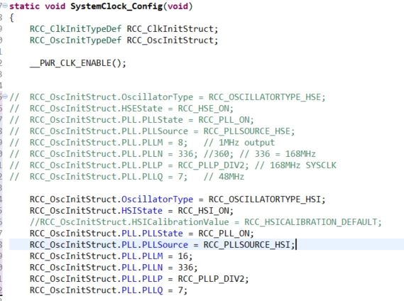

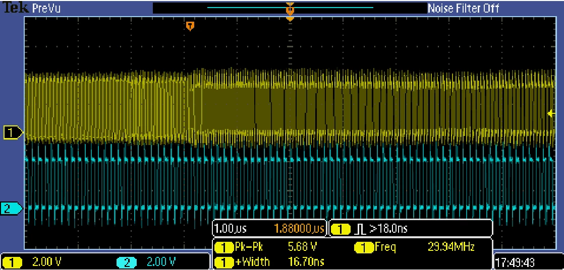

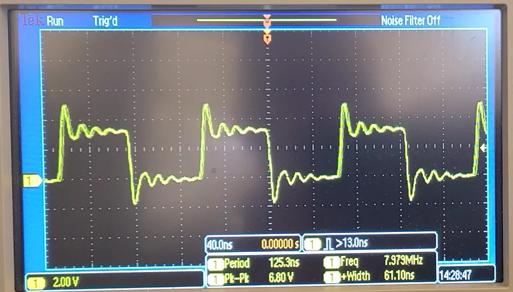

*Update #2
I switched the PLL clock source from HSE to HSI and the SYSCLK transient vanished.
0693W00000GXoALQA1.pngSince this test I turned my attention back to the HSE since there is no other explanation that I can think of. It does appear that there is some measurable difference between a board with and without the transient.

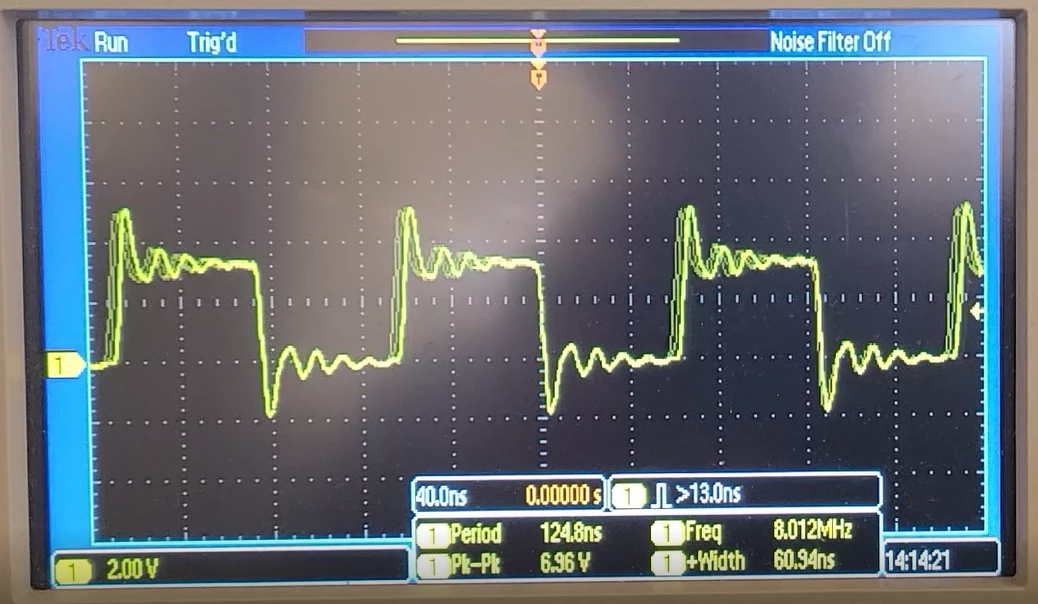

Good board - No SYSCLK or PLL transient
0693W00000GXoItQAL.pngBad board - SYSCLK and PLL transients can occur several times a minute0693W00000GXoJ3QAL.pngWe can see that the "bad board" has more ringing on the HSE than the good board and I believe this may have something to do with the issue.

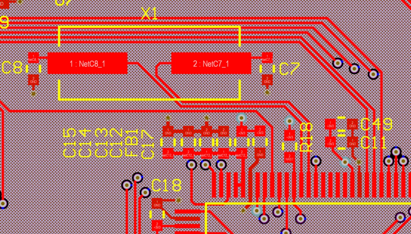

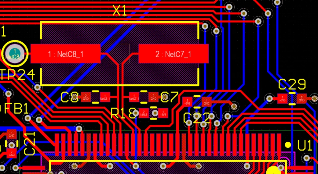

Here are some snapshots of the crystal circuits on good vs bad board. For reference my crystal is ATS08ASM-1E with 18pF load caps C7 and C8.
0693W00000GXoKLQA1.pngBad board - SYSCLK and PLL transients can occur several times a minute. This varies from board to board0693W00000GXoKVQA1.pngIt is also obvious (I think) that the xtal circuit layout on the "bad" board is not optimal and could explain why HSE on these new boards is not working as well.
This all makes sense and I can say that I found the root cause, but there is one annoying thing about this problem that I can't seem to resolve:

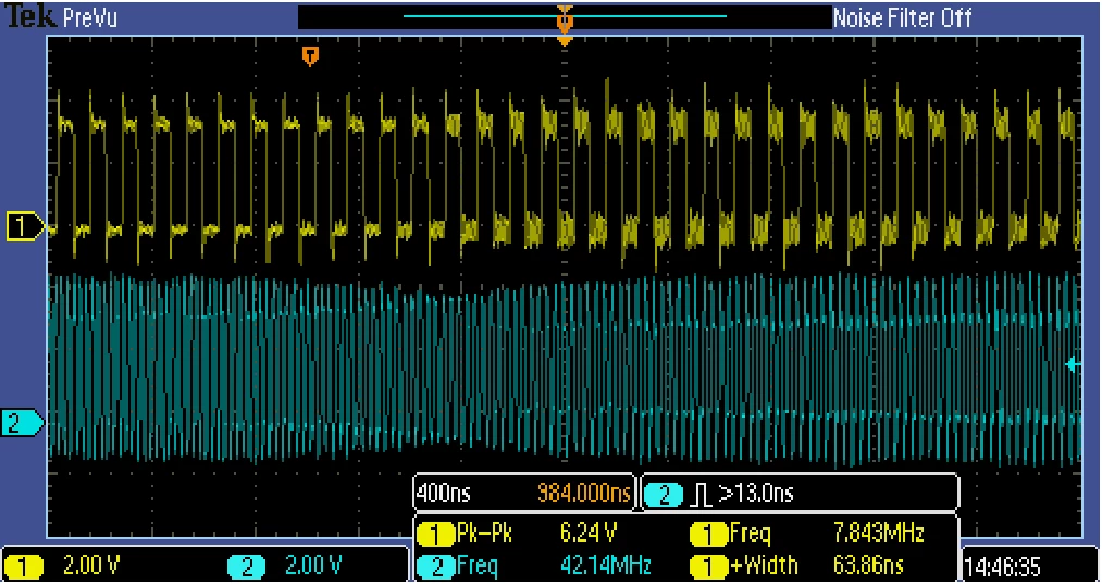

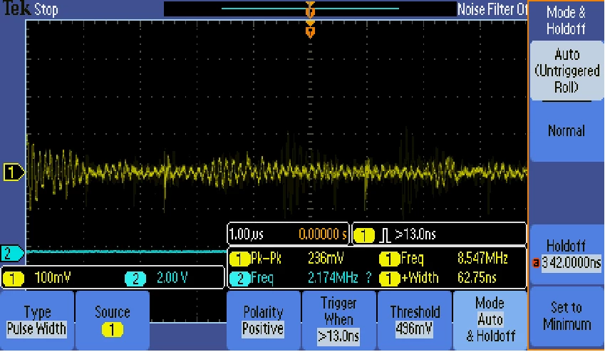

If I monitor SYSCLK and HSE at the same time I do not see anything significant happening on HSE during the SYSCLK transient
HSE (yellow) vs SYSCLK (blue) during transient0693W00000GXoLiQAL.pngNotice that the HSE is getting very noisy when the SYSCLK transient occurs and this is due to crosstalk from the SYSCLK signal affecting the HSE. When I disconnect the SYSCLK (blue) signal from the scope, the noise on HSE goes away. What I'm left with is basically nothing observable on the HSE while the board is having SYSCLK transients constantly.
Here's another capture with less crosstalk, this time HSE in Blue and SYSCLK in Yellow0693W00000GXoMbQAL.pngIt's hard to make out the HSE at this zoom level but there is nothing really obvious here. I can take more captures if anyone wants to see something in particular.
Here are some other observations:
  1. The "good" boards with better xtal layout will occasionally show this problem, just not nearly as much
  2. I can reproduce the SYSCLK transient by poking the xtal load caps with a 120pF capacitor
  3. When manually reproducing the transient I always see something on the HSE, such as amplitude or phase shift or pulse width spikes that lead to the SYSCLK to glitch until the PLL stabilizes
  4. The capacitance measured across the xtal with my 18pF load caps installed is about 20pF which is the spec on the datasheet of the xtal
  5. Swapping the load caps with 6pF, 10pF, 36pF or 100pF does not resolve the problem.
  6. Removing the load caps completely resolved the issue (sample size of one board), despite the HSE becoming even less stable
  7. When I dropped PLLN from x336 to x288 I was able to get the transient to go away if I reset the board enough times (startup condition?)
My assumption based on all of this is that the HSE is unstable and that the PLL is control loop is 'desyncing' briefly causing the SYSCLK transient. It also appears that there are certain levels of instability that allow the PLL to operate without issue? That's the part that is really annoying me haha....
I think it may be time to re-design the HSE circuit.
Anyone have any thoughts on this?
Thanks again for all the help!

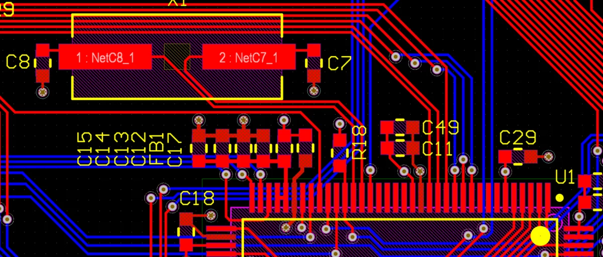

waclawek.jan
November 16, 2021
Show ground.
Does any power or HF current flow through that ground from the caps to the GND pin closest to OSC pins (probably VSSA)? Can this current be correlated to occurence of instability?
Or, the other way round - lift the capacitors and hang on them a wire connected to the GND pin closest to the OSC pins; and observe. PLL/oscillator can still be thrown off by impure VDDA/VSSA, though (I don't know exactly the internal routing of the chip).
KVIZK.1
KVIZK.1Author
November 18, 2021
0693W00000GY3ezQAD.pngThere's a ground plane underneath everything.
I removed the load caps and wired them in from a breadboard with ground going to C14/C15 and that did not help. Having the load caps wired in did make the HSE less stable which is not surprising.
There is some minor noise when I measure between the load cap grounds and the MCU grounds but it looks to be the same on all the boards.
0693W00000GY3glQAD.pngI removed the xtal and load caps from the board and am now injecting an 8MHz waveform that matches the xtal signal from one of the good boards. When I do this the HSE as measured from MCO on my scope looks the most stable I've seen it. The transient is still present in this configuration though which is very surprising. Next test is to experiment with some series resistors on the xtal and then try this test on a good board. If the good board does not show the transient with an external generator that is wired in the same way then it seems to me that the HSE is not really to blame.
Of course the simplest and most likely explanation is that the HSE is to blame and I'm just missing something here....

waclawek.jan
November 18, 2021
OK. It's not necessarily the best method. You may want to separate analog and digital grounds. It's not simple to "see" how currents flow on a plane with holes in it, and where does a heavy digital load generate a possibly high frequency voltage drop.
The 144-pin package is there for a reason. External memories, perhaps? Any other heavy digital circuitry?
Breadboard? I meant, put them "standing", one pad directly on the crystal's pad, the other pad connected to flying lead going as short as possible to the mcu's analog ground.
Are you talking about signal ultimately derived from PLL? PLL may be affected by ground currents, too.
Try switching off everything possible, maybe running a minimal program, and compare the HSE stability and ground differences.
I know this sounds like I'm fixated on one particular theme - and I may be, given past experience, but I am aware of that your case may be different, so please take these just as items of discussion.
