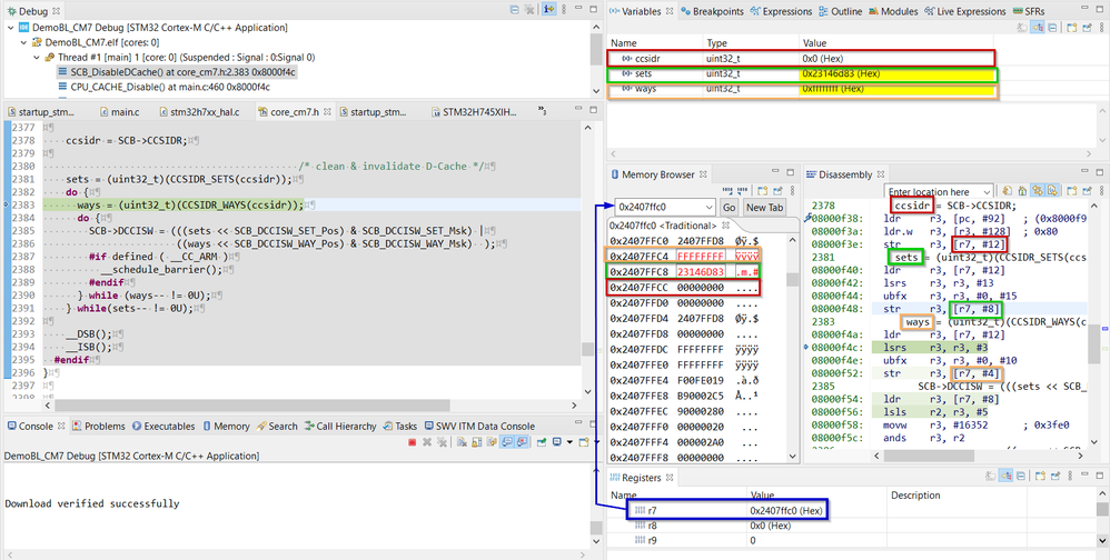

does anybody have a idea why the code is stuck at below do while loop (bold marked)?.
use case: for the boot application , SCB_DisableDCache () is getting called before jumping into use aplication.

    Was DCache enabled before you call this?
    Are you trying to step thru this function in debugger?
    -- pa

    hi , yes i have enabled DCache during init and disabled again in deinit process before jumping into application software.
    no, i just let it running and tried without debugger after flashing too, while debugging its observed code is breaking at i mentioned before.

    Haven't sorted out the exact reason behind it, but cache management functions tend to stuck if you try to debug them by stepping in or even stepping over with a single step. Just let them run normally and use breakpoints to stop at specific code.

    hi Piranha, yes tried the same still issue persists.

    Just for the record, I know what was the reason of the super strange behavior.
    It was flux. The PCB wasn't super cleaned after soldering and it caused super strange behavior.
    The microcontroller was behaving really odd and not only the microcontroller.
    External USB phy also was behaving wacky and even DC/DC converter was giving some strange symptoms and sometimes it even stopped working.
    After a few sessions in ultrasonic cleaner everything started to work as expected.

    No, not likely. Seen this behavior on several ST eval boards.
    When running thru SCB_DisableDCache at full speed, debugger will not hang. Only when single stepping it hangs.
    So this is caused either by single-stepping thru an inline function or some specific handling of stuff related to the cache.
    Just do not single step thru these functions.
