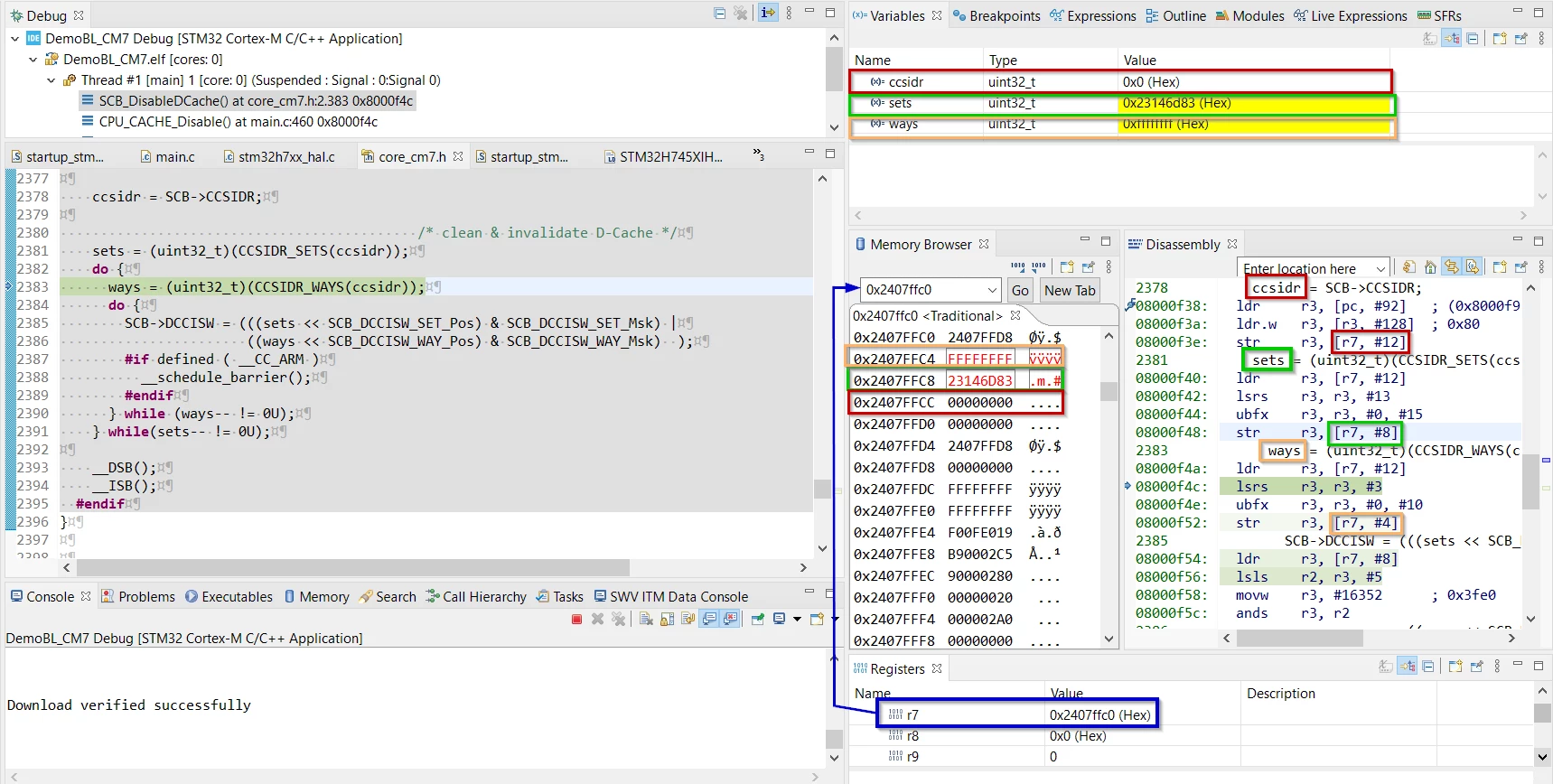

    Feb 3, 2022 1:31 PM UTC
    Hi all,
    have the same issue here: ccsidr, sets and ways are local variables of SCB_DisableDCache() that are stored on the stack. ccsidr is only read once before executing the two nested loops. However, the value changes during runtime - which may be due to some stack issue?
    0693W00000JOPyoQAH.pngEdit #1: This may be related to GCC optimization levels!
    See also: https://github.com/ARM-software/CMSIS_5/issues/620
    Edit #2: Same problem has been described here: https://community.st.com/s/feed/0D53W00000oVveoSAC - also got the same reference from Edit #1
