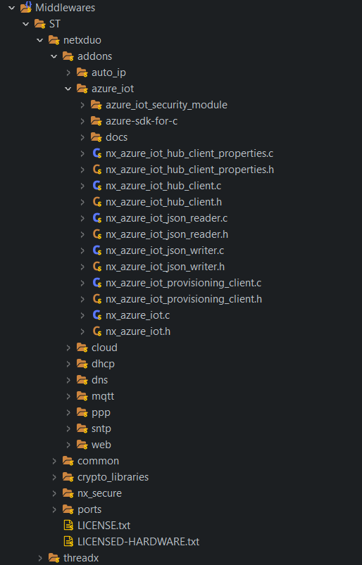

Recently I have been trying to implement an example from ST where data is sent telemetry to Azure. The problem is that Stm32CubeIDE did not generate Netxduo / addons / azure_iot. I am trying to manually add this folder but there are a lot of errors regarding includes and in the example I do not see these folders and files, although in some files they have #include "nx_azure_iot_json_reader.h" which is part of azure-sdk-for-c. If you have any ideas where you need to select somewhere in Stm32CubeIDE to generate this file, please give me advice.

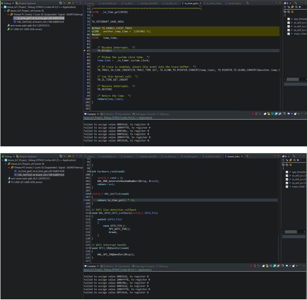

The problem seems to be related with SysTick.

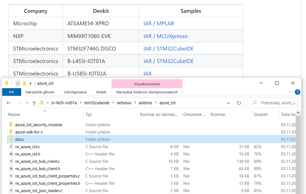

@umtkyck​
I had the same issue and I fixed that by adding manually this package. I had a lot of work but I recommend you download one of these package, choose a project to Stm32CubeIDE then find the folder where is azure_iot and finally copy it to your project and add a path to the linker. I believe that this file (azure_iot) is a general file for any microcontroller and you can copy that peacefully and configure on your own. I hope that it will help you
