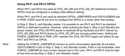

Hi,I used PA12 & PA11 as input gpios(pull-up) in STM32U595VJT6Q ,read the pins are always '0'.The IOs connected NOTHING.
I reference RM0456 :
I config USBPWREN and VDD11USBDIS bits used the HAL functions before  GPIO_Init():
HAL_PWREx_EnableUSBHSTranceiverSupply();
HAL_PWREx_DisableVDD11USB();
BUT I read the pins still '0'.How can i do?

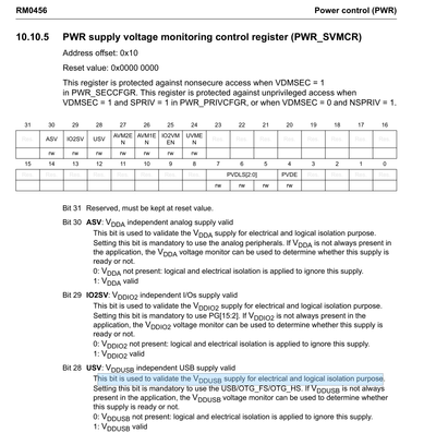

Elatewendy
Thanks @SStor
Solved: Problem with Pin A11 on STM32U595VJ - STMicroelectronics Community
This method is effective.
SET_BIT(PWR->SVMCR, PWR_SVMCR_USV);
SET_BIT(PWR->VOSR, PWR_VOSR_USBPWREN | PWR_VOSR_VDD11USBDIS);

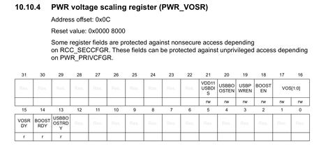

waclawek.jan
Read out PWR_VOSR content and check those two bits in it. If they are not set, check if you've enabled clock for PWR in RCC.
If that's OK, read out and check GPIO registers content.

thank you very much.I have learned:handshake:
waclawek.jan
I'd have a look also at GPIOA->MODER, whether both PA11 and PA12 are set as outputs.
Beyond that, sorry, I don't know what else to check.

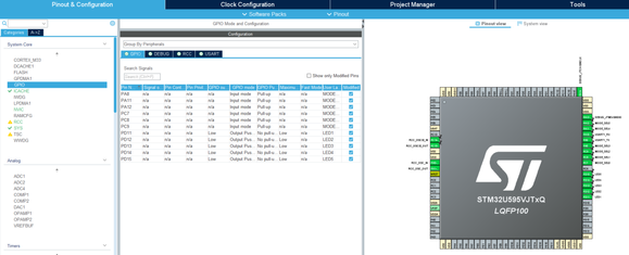

Hi,my project is created by CubeMx.
The GPIO configured like as:
