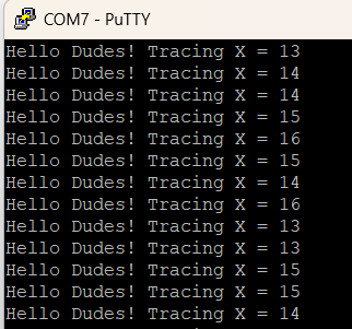

To exclude issues with debug mode I build release with the measurements being send out through the UART3.
Still measurements as before are incorrect.

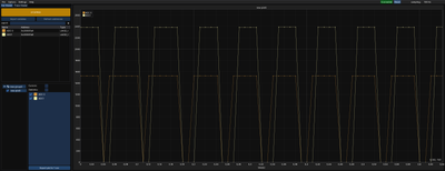

I did monitoring of 2 out of 4 channels using MCUmonitor and did notice that the reading periodicaly drop to 0.
Is that something else is trying access the same ports as ADC inputs. How to check it?

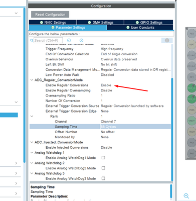

OK I solved the problem for the single channel reading.
It seems there is serious bug in the CubeMx. It doesn't generate complete initialisation code.

I am sorry, I was wrong again.
In fact when I did not select the option "Enable Regular convertions" (Cube allows for that) it doesn't generate the Rank for single input.
As result there was no input selected in PCSEL register and so I measured nothing getting the values around 15cnts. When I corrected it I started to get different values like 208cnts. Still doesn't make any sense assuming there is 0,833..V at the input. Then I accidentaly change the input setting from single-ended to differential. I got then value around 5440cnts. By accident it was really close to the value I had at the input so I assumed I solved problem somehow.
But it was false assupmtion. No matter which of theese three cases I have they have one thing in common.
They don't change at all no matter what I have at the input. So even if I am change this 0,833V to anything else from the range the readings ale all time tha same with little noise ( +/- 5counst or so)
For some reason it looks like my ADC is totaly disconnected from the input.
I tried to swtich to other inputs as well but no change.
In the picture you posted above, you were getting readings but about 50% of them went to 0. I wouldn't say the ADC looks disconnected. Are you now seeing different behavior?
