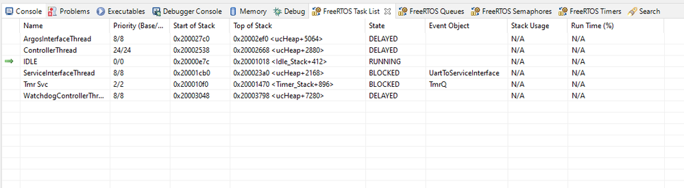

Dear Matthias,
first of all, thanks for the great debug capabilities for FreeRTOS in CubeIDE, I'm using them on a daily basis.
The only issue I have is with the "Stack Usage" and "Run Time" reporting in the "FreeRTOS Task List" tab which never shows any information:
Is this some configuration issue with FreeRTOS or are these features not implemented yet?

Ok @Chris F​, thanks for feedback! Nice it seems we have 2 users using these features now... ;)
The Stack usage and the Run Time views require building FreeRTOS with some extra defines and setting up a timer.
You can read about this in CubeIDE User Guide in the FreeRTOS section 6.2. Have a look at 6.2.1 Requirements. FreeRTOS 10.0.1 is from around 2018. I think it should support that feature, but not 100% sure.
Kind regards, Mattias

This is correct. You need to enable stack reporting and likely stack checking (I do these by default). To get runtime, you need to enable a faster timer, say about 100 us to perhaps 10 us (your choice), and look at uxHighFrequencyTicks as a variable. Digging through the documentation about each particular feature on the FreeRTOS website will give you examples. These features are NOT automatically enabled. The other thing to note is that Runtime and the like cannot be used with optimization other than O0. You can either take care of this by setting the entire C compiler to O0, or just tasks.c to O0. Setting everything to O0 makes debugging easier at the expense of larger flash size.
