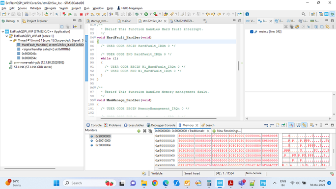

I followed exactly the same instruction given in AN5188 and written Boot and app code like example code you given for STM32H7 only, but when i execute the jumpToApplication(); line, i am always getting Hard fault error.
Before executing jumpToApplication(); line, i am able to see the actual external memory data like below,
After executing jumpToApplication(); line, i am seeing corrupted data in external memory like below, but the data is not corrupted actually.
Tesla DeLorean
Guru
April 30, 2024
Don't repeat the clock and memory initialization in the application code.
Get the loader code to bring up the system in the desired configuration, at least the key settings for clock, plls, pins, external memories. Other pins/peripherals you can defer until later. Teardown any other interrupts you have going before transferring control.
Watch HAL_Init() and don't be doing SystemClock_Config() for a second time.
Watch also what SystemInit() is doing with SCB->VTOR, I'd use a linker symbol over a define, but make sure the vector table is pointing at your new location.

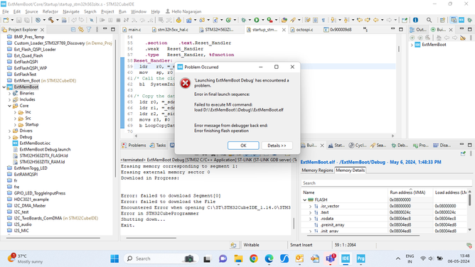

NagarajanAuthor
May 6, 2024
I am able to download the entire code in external QSPI flash with the help of external loader but if i want to keep particular section alone in external memory, i am getting the below error while downloading. Could you please help me to find the reason for this issue. I attached linker script with this chat.
This below variable only i want to move to external memory,
uint8_t buff[10] __attribute__((section(".extflash")));
Note: As i couldnt upload the .ld file directly, i just changed as a .c file.
Tesla DeLorean
Guru
May 6, 2024
Use STM32 Cube Programmer, show complete error, ideally with adequate logging to be able to get some clue as to what is happening.
Show whole memory map for the built file, only see internal FLASH addresses in your screen shot

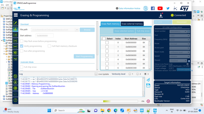

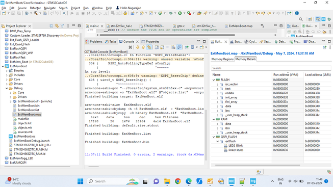

NagarajanAuthor
May 7, 2024
If i download it through cube programmer, it stuck up with the below page itself. it's not even start downloading at all. Attached map and linker file for your reference.
NagarajanAuthor
May 9, 2024
Is it possible to download code to internal as well as external memory at the same time using cube programmer?
If yes, which address should i give as start address?
With cube IDE i am able to download but cube programmer i am seeing the hang like below.
Tesla DeLorean
Tesla DeLoreanBest answer
Guru
May 9, 2024
You'd need to split the data into TWO .BIN covering the individual regions which are otherwise a long way apart, resulting in a file that's 2GB in size, and clearly not going to fit within a device with a fraction of that capacity.
A .HEX or .ELF can be sparse
