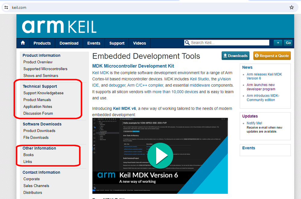

For help with Keil, see:
https://www.keil.com/
