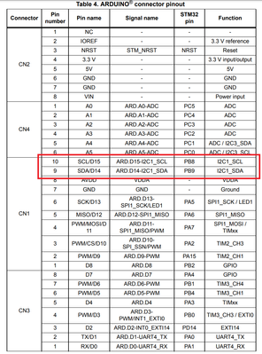

I noticed that in the STM32CUBE Ide you can configure the pins D14/D15 (PB8/PB9), which are normally used for I2C, for Can Tx/Rx?

also to the user manual of the board: need to connect a transceiver to the connector CN1 / pins 10 and 11:

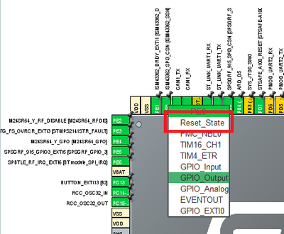

It's possible to use CAN on this board over PB8/PB9 pins.
You need just to reset the pins for I2C function and activate CAN1.
Attached an ioc file where CAN1 is enabled.

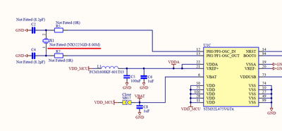

But becarefull: you need to use HSE with an external cocurate clock source for example a crystal . Internal oscillators are not recommended for CAN communication in Normal mode.
According to the schematics,  the 8Mhz crystal is not fitted, so you need to solder one:

Thank you for the detailed answer. I'm not sure where on the board this schematic pointing to. As well as this it is, unfortunately, school property. There are another set of pins (PD0/PD1) in the PMOD external connecter block that can be configured for CAN tx/rx it seems. Would I still need to solder on a crystal?
