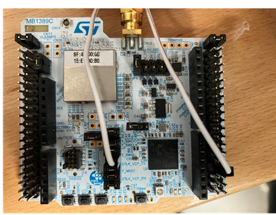

my nucleo WL55JC1 board is not detected by cubeide when I want to run (No ST-LINK detected). The com led lights up green and with the st-info --probe command I find STM32WLEx for the dev-type. I can also update the st-link via cubeide but as soon as I close stlink upgrade and open it again the version is Unknown.
I'm testing with the LoRaWan_End_node example code.
Cubeide Version: 1.15.1
st-info Version: v1.8.0-18-g765ebda
Thanks in advance

Hello @PodePode
what kind of hardware do you use to link the board with your pc?
can you please sent a picture of the board in use especially the state of the jumpers?
for me I use a normal USB cable (type A to micro USB type B)

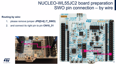

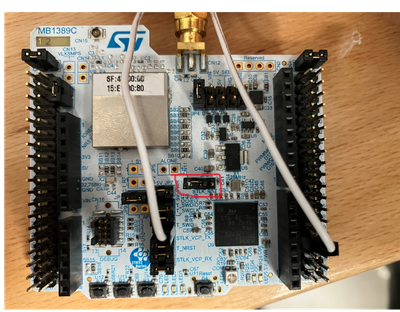

I am working with the same device and also with the WL55JC2 bord, and I have the first problem at the first Time and I found this image
please note that jumper JP6 is removed. 
I worked with it at the first Time and next I reconnect the jumper jp8 [5,6] and it works.
I hope this information is helpful!
