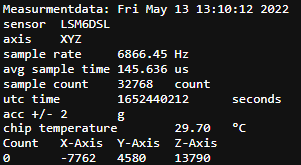

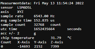

Svan .8
Hi Eleon,
we face the problem that the output data rate (ODR) of different product batches differs significantly. Batches with the mark 940 are close to a sampling rate of 6600Hz. And Batches with the mark120 are close to 7000Hz.
Do you have any information on why the tollerances are so large?
Svan .8
Here are some addition measurements which we have done. Hardware-setup was the same.Only the chips are changed between this measurements.
Labeled with 1200693W00000NpvD1QAJ.pngLabeled with 940
