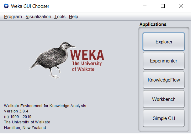

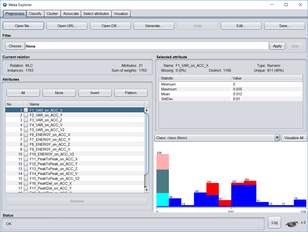

Ø Launch Weka tool and push the “Explorer” button
Ø Load the ARFF file created before by pushing the “Open file…” button in the “Preprocess” panel. Once the file is open you may be able to see all the Attributes (Features and Classes) that we selected with the Unico GUI.

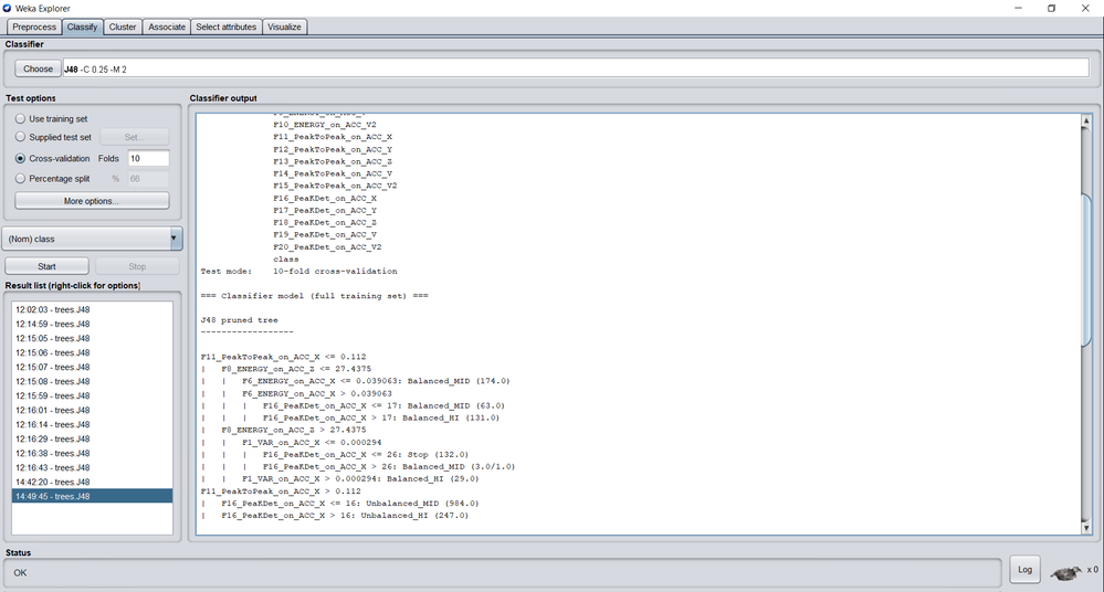

Ø We can now choose in Weka the desired ML algorithm, in our case the Decision Tree, by selecting “Choose >> trees >> J48”. Then Push the “Start” button.
Ø Copy and paste the information relative to the Decision Tree model trained by the Weka tool:
J48 pruned tree ------------------ F11_PeakToPeak_on_ACC_X <= 0.112 | F8_ENERGY_on_ACC_Z <= 27.4375 | | F6_ENERGY_on_ACC_X <= 0.039063: Balanced_MID (174.0) | | F6_ENERGY_on_ACC_X > 0.039063 | | | F16_PeaKDet_on_ACC_X <= 17: Balanced_MID (63.0) | | | F16_PeaKDet_on_ACC_X > 17: Balanced_HI (131.0) | F8_ENERGY_on_ACC_Z > 27.4375 | | F1_VAR_on_ACC_X <= 0.000294 | | | F16_PeaKDet_on_ACC_X <= 26: Stop (132.0) | | | F16_PeaKDet_on_ACC_X > 26: Balanced_MID (3.0/1.0) | | F1_VAR_on_ACC_X > 0.000294: Balanced_HI (29.0) F11_PeakToPeak_on_ACC_X > 0.112 | F16_PeaKDet_on_ACC_X <= 16: Unbalanced_MID (984.0) | F16_PeaKDet_on_ACC_X > 16: Unbalanced_HI (247.0) Number of Leaves : 8 Size of the tree : 15

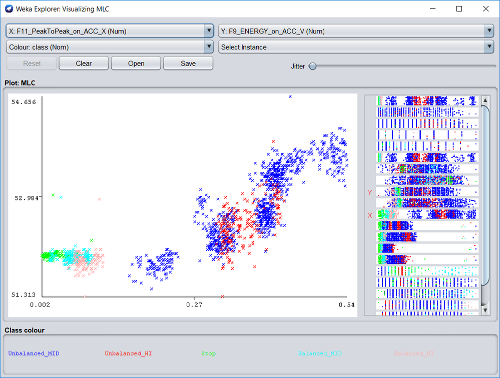

Ø In the case it’s needed to analyze more in details the dataset used, it’s possible also to visualize in Weka some plots for the values of each Feature relative to the different classes in the “Visualize” panel.
It’s important to pay attention to the possible issue of overfitting, typical of Decision Tree algorithm: the accuracy on the training dataset may be quite high (also close to 100%) but the model may fit “too much” the data collected for the training, and may not work “so well” in the real application. To minimize this possible issue it’s important to collect a large dataset in different application/environment conditions in order to make the solution as much as possible robust to different conditions. In the case of this vibration detection demo, position of the vibration absorber has been changed for ach data log.

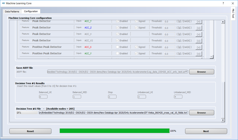

We need to come back now to the Unico GUI we left open and load the .txt file with the Decision Tree configuration.
Ø Click on "Next" and leave default options for the Meta-classifier
Ø You will be able to save the configuration .ucf file for the LSM6DSOX

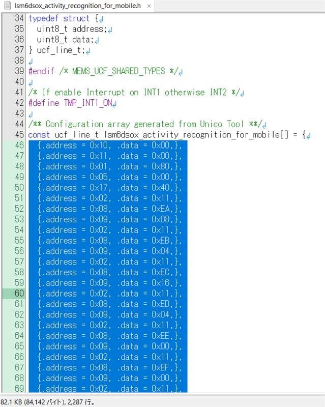

We need now to convert the .ucf configuration file in a c source file to be updated in the STM32 project. We can use Unico GUI to do it:
Ø In the “Options” Tab push on the “C code generation...” button, load the .ucf file created before and push “Generate C code” button.
Ø A file with the same name of the .ucf file but with .h extension will be generated
Ø From the .ucf file copy and paste the table of the LSM6DSOX registers updating the one already present in the file lsm6dsox_activity_recognition_for_mobile.h:
Ac 10 00 Ac 11 00 Ac 01 80 Ac 05 00 Ac 17 40 Ac 02 11 …
The first column represents the Sensor Register Address and the second column the Value.
Ø Recompile and download the updated FW on the STM32.

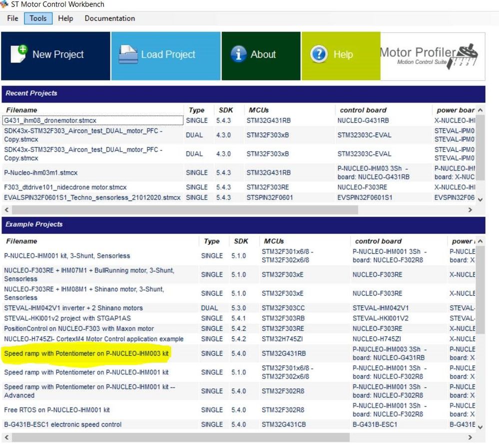

A) Download Motor Control SDK for STM32 and install the tool:
B) Load the P-NUCLEO-IHM03 pre-loaded project “Speed ramp with Potentiometer on P-NUCLEO-IHM03 kit” and generate FW project source code for STM32G431:
