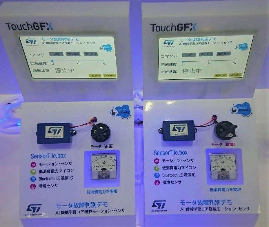

The demo project is intended to show the capabilities of Machine Learning Core (Decision Tree model) of LSM6DSOX using the accelerometer data to detect the status of a motor in 5 different conditions:
  1. Motor Stop
  2. Balanced Motor running mid speed
  3. Balanced Motor running high speed
  4. Unbalanced Motor running mid speed
  5. Unbalanced Motor running high speed
The demo is using the following Hardware:
Ø  SensorTile.box (STEVAL-MKSBOX1V1): LSM6DSOX detects motor status thanks to MLC, and when status is changed the application MCU on board (STM32L4R9) sends the updated status by BLE (SPBTLE-1S) to a BLE master.
Ø  NUCLEO-F401RE + X-NUCLEO-IDB05A1: acting as BLE Master, after establishing connection with SensorTile.box, it receives motor status information by BLE messages and re-direct as plain text to UART.
Ø  EDT 7-inch Smart Embedded Panel with STM32F746 and TouchGFX library: the motor status data received by UART are displayed on the LCD screen thanks to TouchGFX library. It’s possible also to send commands to the Motor Control Board to run, stop and change speed of the motor.

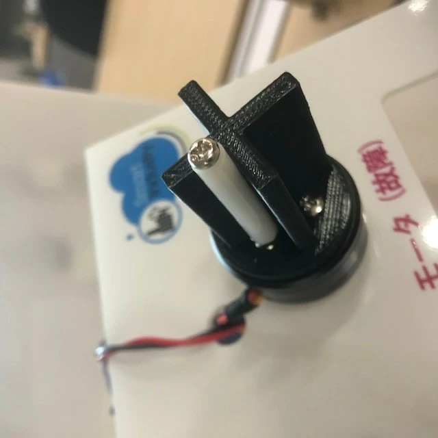

Ø  [Optional] Plastic Spacer of 7mm to create an unbalance.

The unbalanced condition is created simply by adding a spacer in one of the motor screw holes.

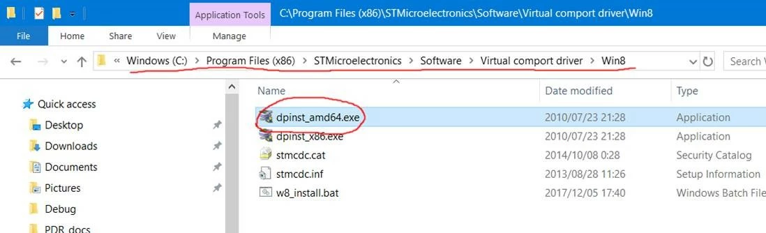

The installer program should also install the Virtual COM driver for the PC, in order to can connect the SensorTile.box to the PC via USB cable and seen as a COM port. If any issue with the driver after the installation, please proceed to install manually launching the driver installer from the following path:

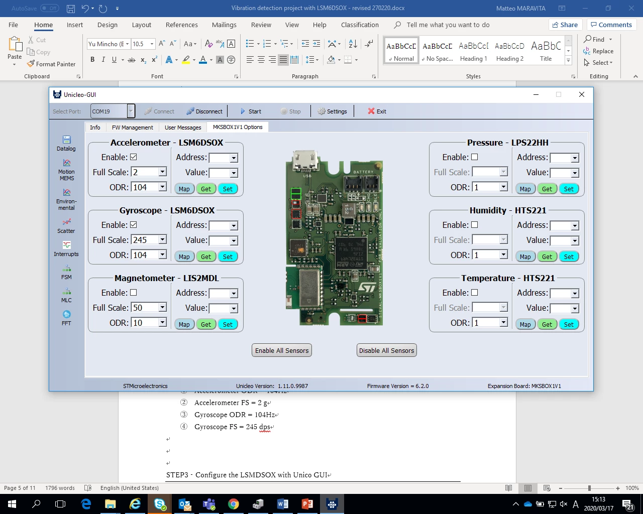

STEP3 - Configure the LSMDSOX with Unico GUI

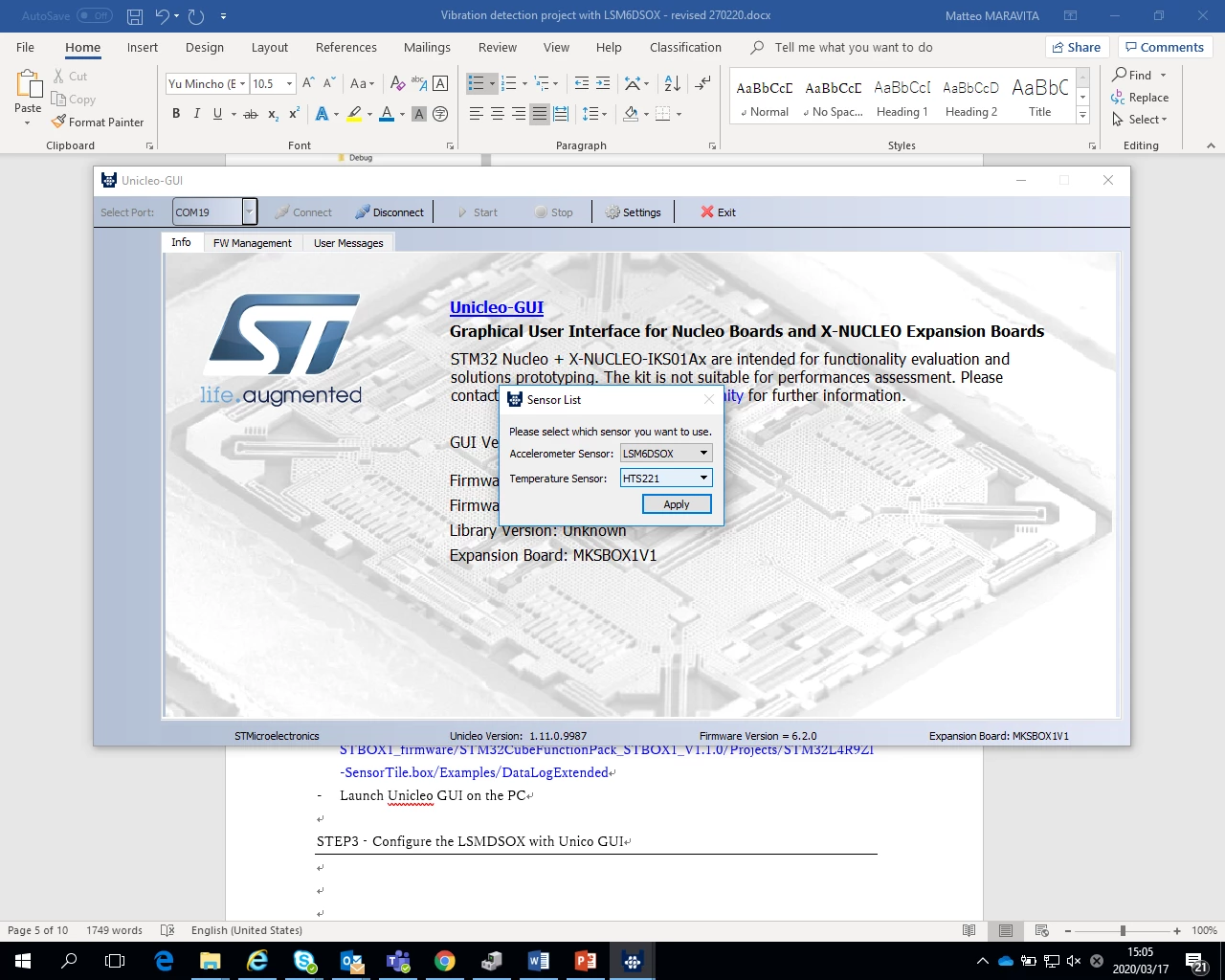

Ø  Launch Unicleo GUI on the PC and click on button Connect and Apply:
Ø  Enable Accelerometer and Gyroscope sensors and configure the following settings:
Accelerometer ODR = 104Hz
Accelerometer FS = 2g
Gyroscope ODR = 104Hz
Gyroscope FS = 245dps
Ø  Click on the Start button on the top Tab.

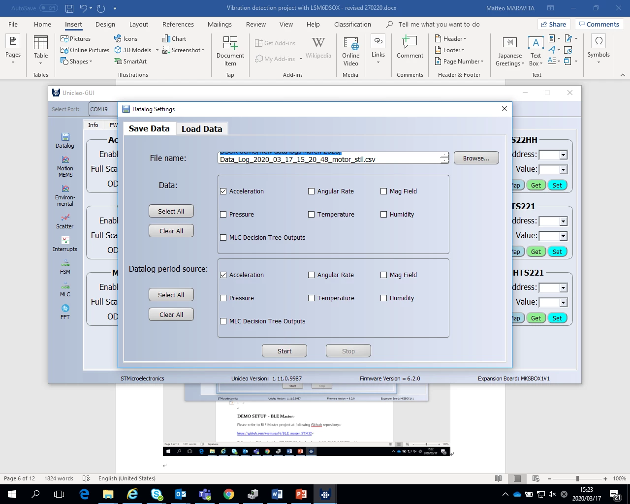

STEP4 - Log Motion MEMS sensor RAW data (ACC+GYR)
It’s possible now to log the data of the accelerometer for the different classes to be identified.
Ø  Run the motor accordingly to the class to be identified
Ø  Click on the Datalog tab
Ø  Enable Accelerometer in the Data and Datalog period source tabs
Ø  Decide a meaningful name for the data log file. It should be easy later to understand the class from the file name.
Ø  Click on Start button
Ø  Wait few seconds to log enough data samples and then click Stop.
Ø  Repeat the procedure few times for each class, in order to create the desired dataset.

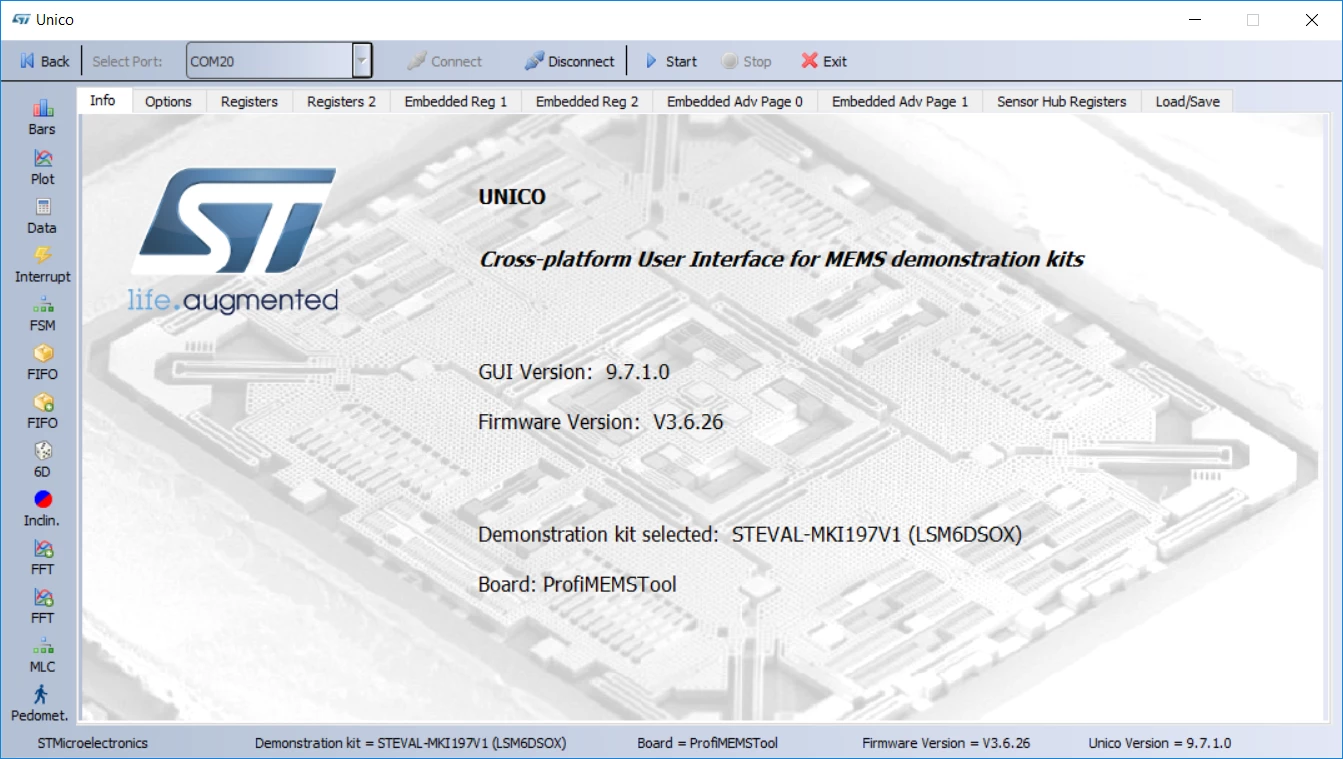

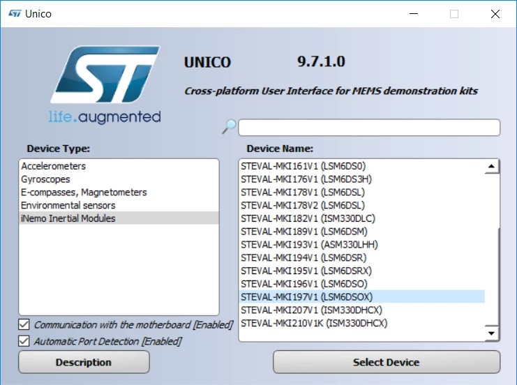

Ø  Connect to the PC the STEVAL-MKI109V3 + STEVAL-MKI197V1 boards with a USB cable, open the Unico GUI and select the iNemo Inertial Modules >> STEVAL-MKI197V1:

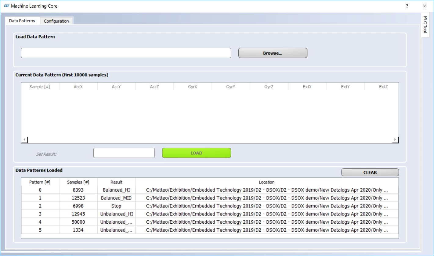

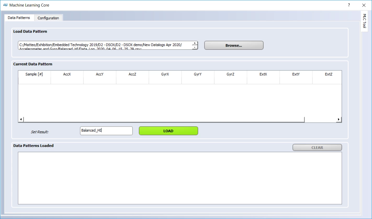

Ø  Select MLC Tab, start loading all the .csv log files relative to one class, assign a “Result” name (name of the class that will be identified) and push the “Load button”. The Unico GUI will import all the RAW data and split automatically between ACC and GYR data.
Ø  Repeat the same operation for the other classes to be identified

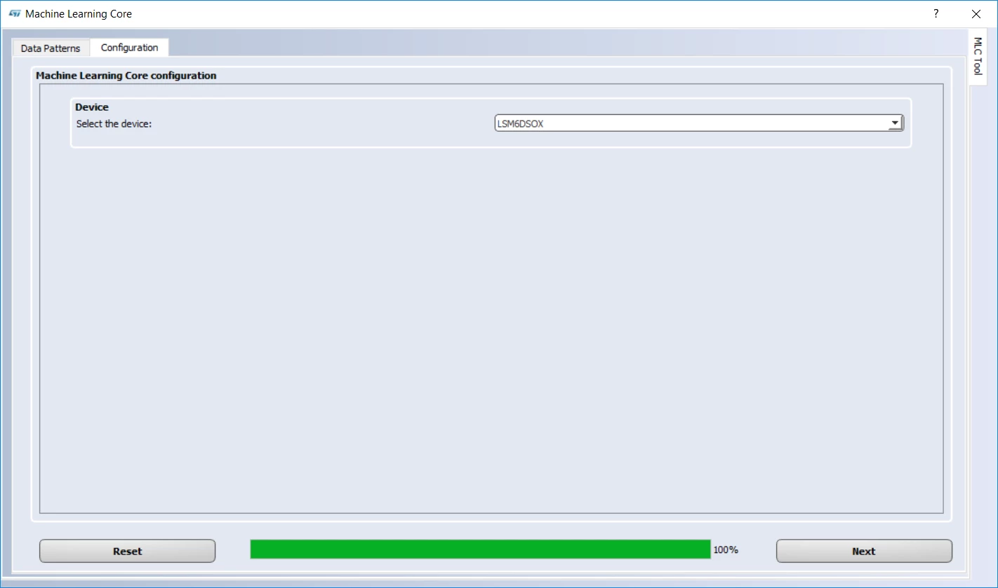

Ø  Configure the parameters in the Configuration tab: iNemo Inertial Modules >> STEVAL-MKI197V1:
Ø  Configure the Accelerometer and Gyroscope settings as following:
Machine Learning Core: 104Hz
Accelerometer: Full scale 2g, ODR 104Hz
Number of Decision trees: 1
Window length: 208 samples (104Hz, 2sec)

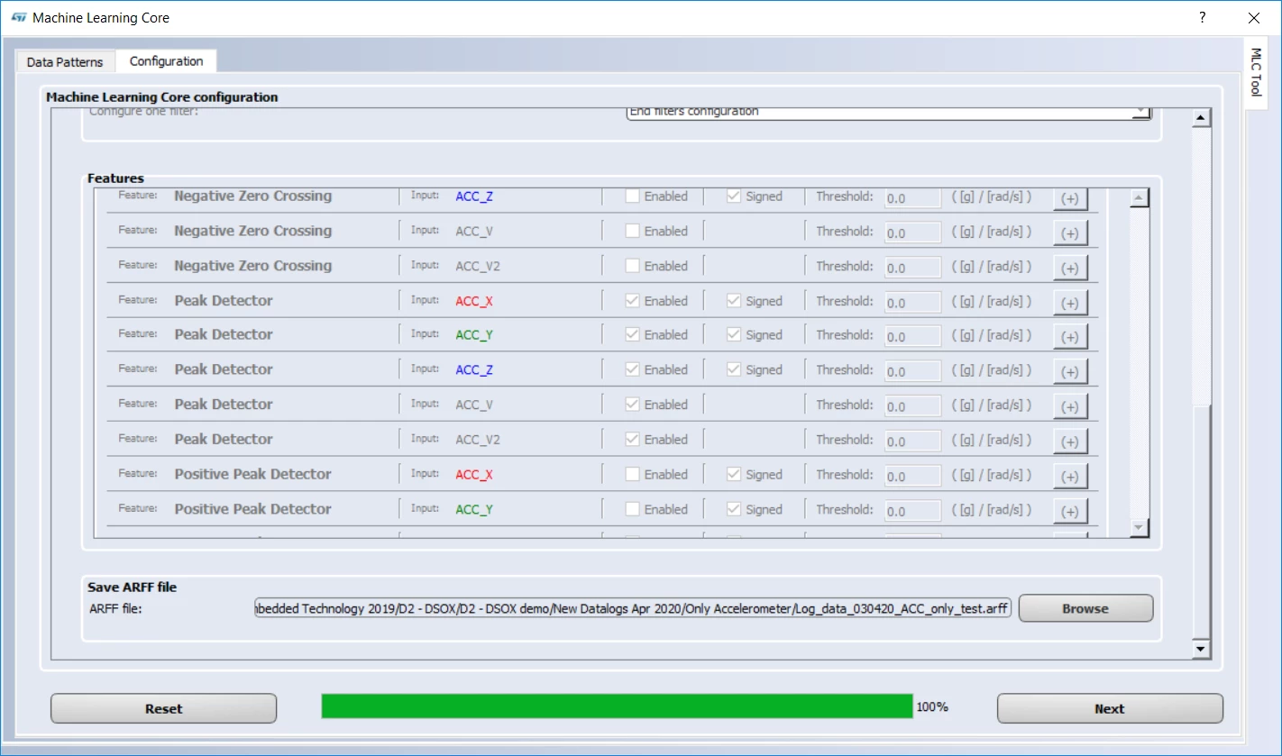

Ø  Configure the Features as following:
Variance (AX,AY,AZ,AV,AV^2, GX,GY,GZ,GV,GV^2).
HP Filtered Energy (AX,AY,AZ,AV,AV^2, GX,GY,GZ,GV,GV^2).
Peak to Peak (AX,AY,AZ,AV,AV^2, GX,GY,GZ,GV,GV^2).
HP Filtered Peak Detector (AX,AY,AZ,AV,AV^2, GX,GY,GZ,GV,GV^2).
Ø  Save the .ARFF file in a desired folder.
Ø  At the Next step the Unico GUI will ask you to load the Decision Tree file. Keep the window open and proceed to the next step to train the DT model.
