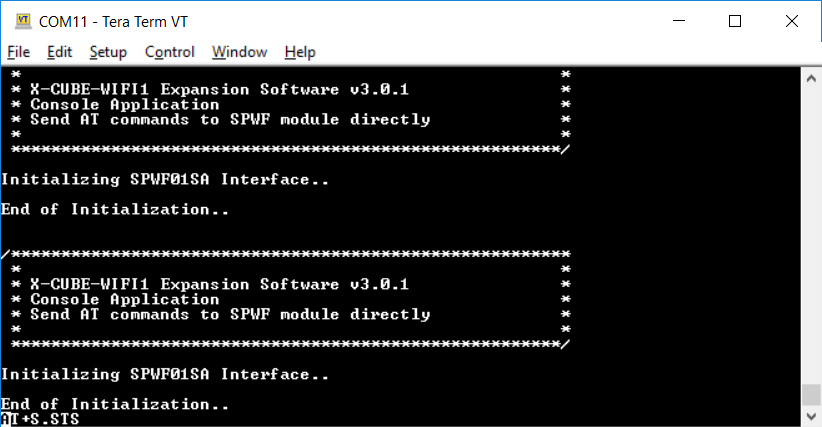

Hello!
I recently bought the IDW01M1 WiFi expansion board
and I am trying to have it working with the STM32F411RE.
However, from the examples in en.x-cube-wifi1_firmware.zip,
I can find the .bin file for STM32F401RE-Nucleo only
and so I tried to flash this WiFi_VCOM .bin to the STM32F411RE board.
I can see LED1 is green, so power is ok.
No other LED On, so module is ok?!
When I use Tera Term, I don't see any output and when I send 'AT', no 'OK' either.
So my question is that  F401RE .bin image cannot work directly on F411RE board please?!

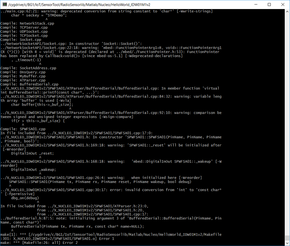

Therefore, I used
https://developer.mbed.org/teams/ST/code/HelloWorld_IDW01M1v2/compile
to trace out all the files that got compiled by the online mbed compiler and then downloaded all the related *.cpp/*.h to mimick the same.
However, it still doesn't work well as I still have the following compile error which I cannot figure out at all?!
0690X00000606nYQAQ.pngI
I don't know why the codes in SPWFSA01.cpp would cause this invalid conversion from 'int' to 'const char*' error...
   SPWFSA01::SPWFSA01(PinName tx, PinName rx, PinName reset, PinName wakeup, bool debug)
    : _serial(tx, rx, 1024), _parser(_serial),
      _reset(reset, PIN_OUTPUT, PullNone, 1),
   _wakeup(wakeup, PIN_OUTPUT, PullNone, 0),
    dbg_on(debug)  <=== Problem HERE?!
    _serial.baud(115200);  // LICIO  FIXME increase the speed
    _parser.debugOn(debug);
Any idea please?!

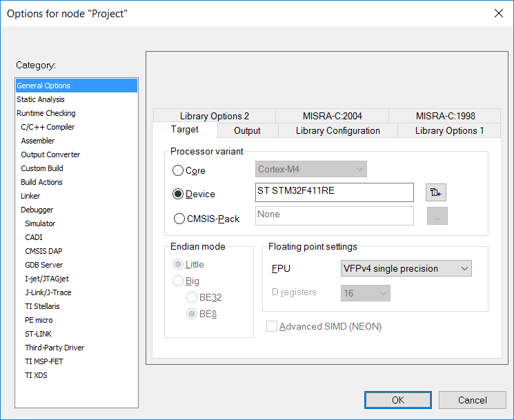

I modified the IAR Project General Setting like this:-
but not sure if any other details I may have missed?!

here is a quick way to port to F411RE which I tried.(of which you have already done some steps)
Let's take the example of the WiFi_VCOM Application and toolset IAR (EWARM folder).
1. Inside EWARM, copy the 'STM32F401RE-Nucleo' and rename to 'STM32F411RE-Nucleo'
2. Copy two files: 'startup_stm32f411xe.s' and 'stm32f411xe_flash.icf' inside above created folder (You can find these files in examples of STM32Cube_FW_F4_Vx.yy.0 driver applications downloaded from the st website)
3. Open the project.eww and then open Project Settings
4. In 'General Options' tab, select correct device name: 'ST STM32F411RE'
5. In 'C/C++ Compiler->Preprocessor' tab, change 'Defined Symbols:' value: STM32F410xE to STM32F411xE
6. In 'Linker->Config' tab, select correct linker script file 'stm32f411xe_flash.icf' (already copied to home directory in previous step)
7. In workspace project file view: Example->EWARM-> select correct startup file: '
' (already copied in home directory in previous step)
8. Build Project-> should be clean without errors.
Run project and check.
Type in console (tera-term). By default, module echo is OFF, so you will not see what you type unless you enable echo on your terminal.
Type AT and press enter and you should see OK as response on the terminal.
Test other AT commands.(e.g. AT+S.STS, AT+S.GCFG=...etc.)

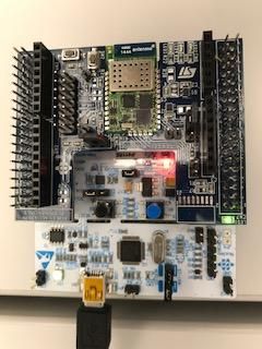

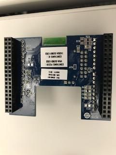

And I also tried to capture my setup photos for you to check here please.
Thanks & Best Regards,
Robert

Photos would be far more effective at higher resolution, the new iteration of the forum is not limited to 100KB images, 2-3MB JPEGs will work much better, and the forum can scale.

    return 0;
  printf('\r\nInitializing complete.\r\n');
  1. But it gets stuck at wifi_reset() inside the wifi_init().
  1. Therefore, I suspect if my STMF411XE.ld or Makefile may still be incorrect?!
     Or if it would be even worse if it is due to any mix-up of HAL_xxx drivers please?!
Any suggestion please?

Robert Kwan
May 30, 2017
Posted on May 30, 2017 at 12:08
Thanks, Jerry.
However, I think that you did not get my point from my previous post.
The sample reference code would work on the HW already, so nothing wrong with the HW, I believe.
It is more on the combination on using mbed HAL driver vs the different driver implementation of the sample reference code here...
And I have no clue on how to fix that as I cannot tell where the problem may be in which driver component?!
Or it may be the linkerScript.ld difference between the sample code implementation and mbed HAL implementation, I suspect... but again, I don't know how to deal with that.
Any other suggestion please?
Thanks & BR,
Robert
