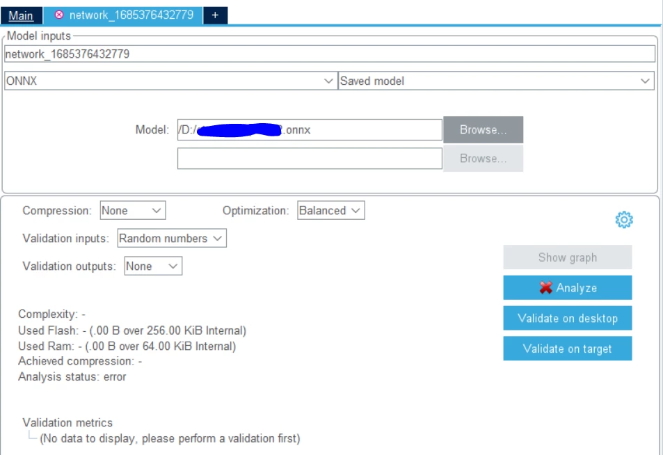

    can you see if you have the same behavior when you actually add the X-CUBE-AI extension in an MX project, not only the MCU finder.

    That is the point, I want to know which MCU of your roadmap has enough flash/ram to run the NN.
    For sure selected is not enougth.

    From what I can see your model doesn't go through the stm32ai command line, you probably have more info either in the STM32CubeMX log or doing Windows->Output in MX.
    Are you using the same version of the command line when it succeeded ?
    Above you have weights=626,620 act=259,200 ram_io=3,300, you can add to that around 30k of flash for the library so you'll need an mcu with at least 660k of flash and 270k of ram. Of course on top of that you need to add the space for your program.
