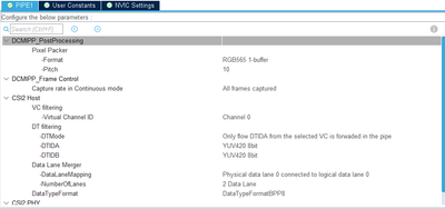

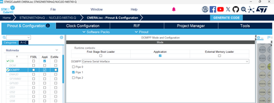

whoamiAuthor
Apr 8, 2026 4:08 PM UTC
Hi @Julian E.  !
Thank you for your reply !
I consulted this repo https://github.com/STMicroelectronics/x-cube-n6-camera-capture/tree/main and using the binary i managed the camera to work as a webcame , but now i'm trying to build my own project but im finding a problems getting it to work .
I'm trying to find  what configuration should be done through reverse engineering the code of this project. However since this project implements a lot other topics (FreeRTOS , usb ...) im getting stuck within this code .
For now i managed i figured that i should use the pipe 1 for my project but still not getting how to configure these parameters .
I had also read this application note AN6211 but still not getting it right
is ther any simple project that i can consult !
