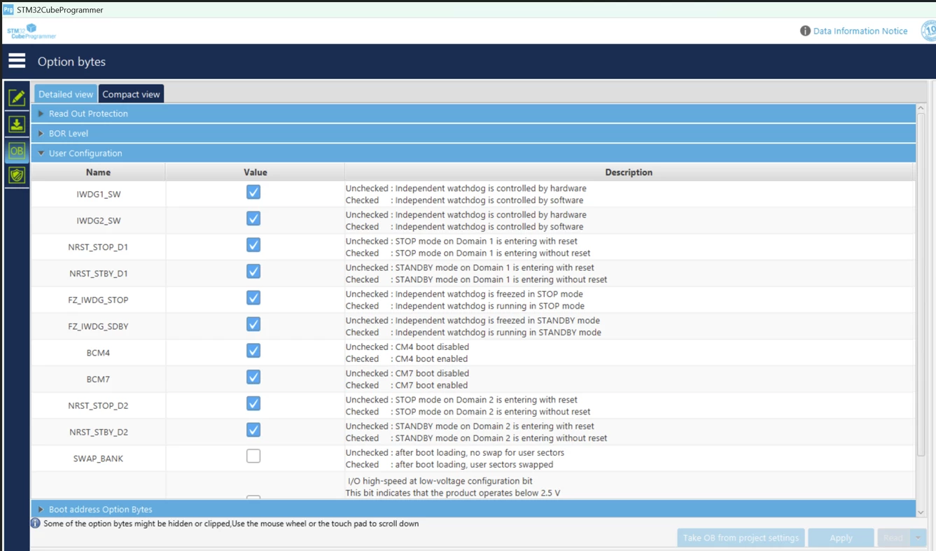

I am working with a custom PCB using STM32H745XI6 (dual core CM7 + CM4).
I wanted to boot only the CM4 core.
So, in STM32CubeProgrammer --> Option Bytes --> User Configuration:
  • I unchecked BCM7 (CM7 boot disabled)
  • BCM4 remained enabled
  • I clicked Apply
  • The operation completed successfully
  • No mass erase warning
  • No security warning
  • No RDP Level 2 warning
RDP was never changed manually.

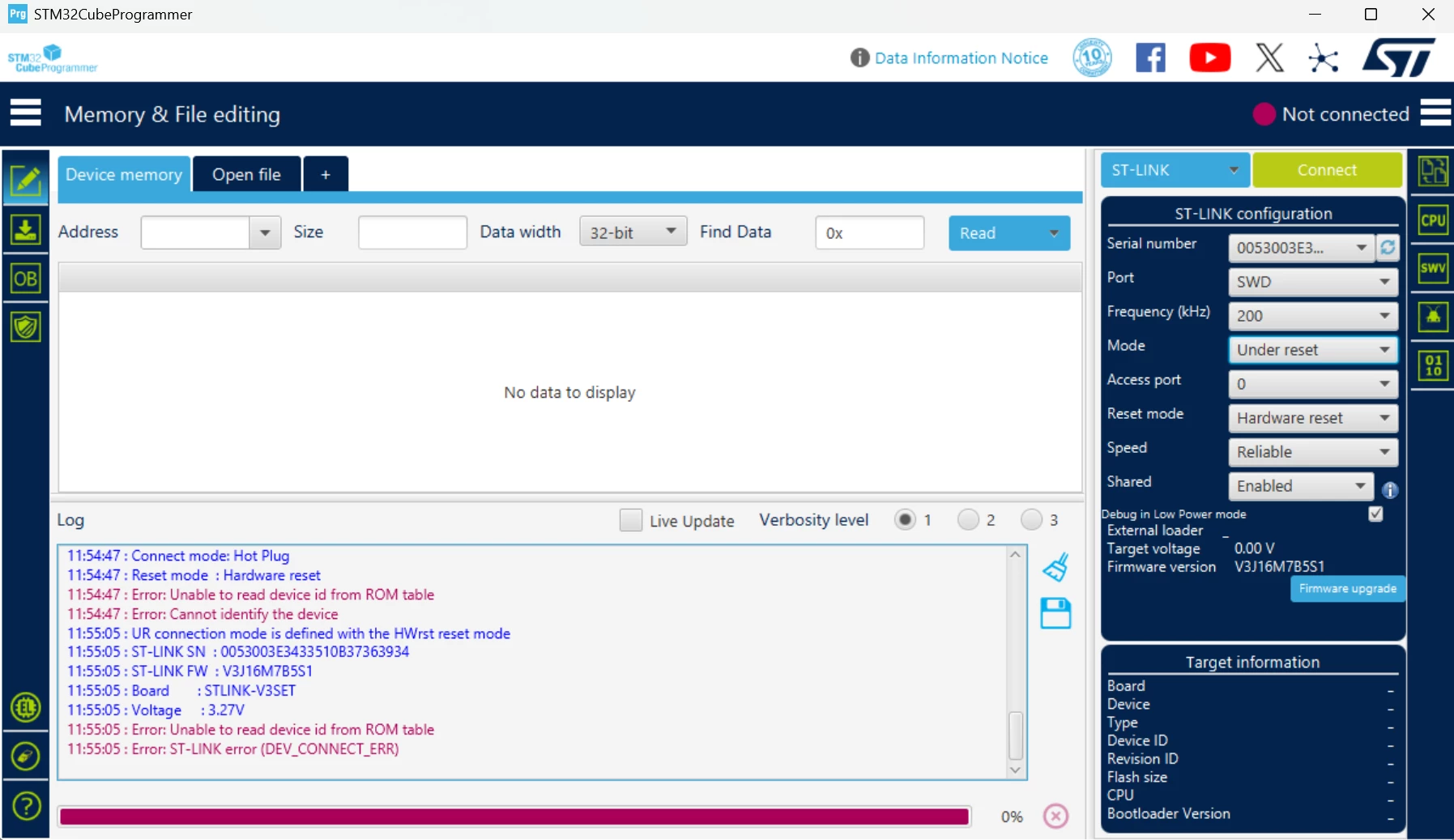

Problem After Applying
After applying the option bytes, I can no longer connect via ST-LINK.
STM32CubeProgrammer shows:
Error: Unable to read device id from ROM table
Error: ST-LINK error (DEV_CONNECT_ERR)
Error: Cannot identify the device
Even in:
  • Under Reset mode
  • Hardware reset mode
  • Hot Plug mode
  • 50 kHz SWD frequency
Connection always fails.

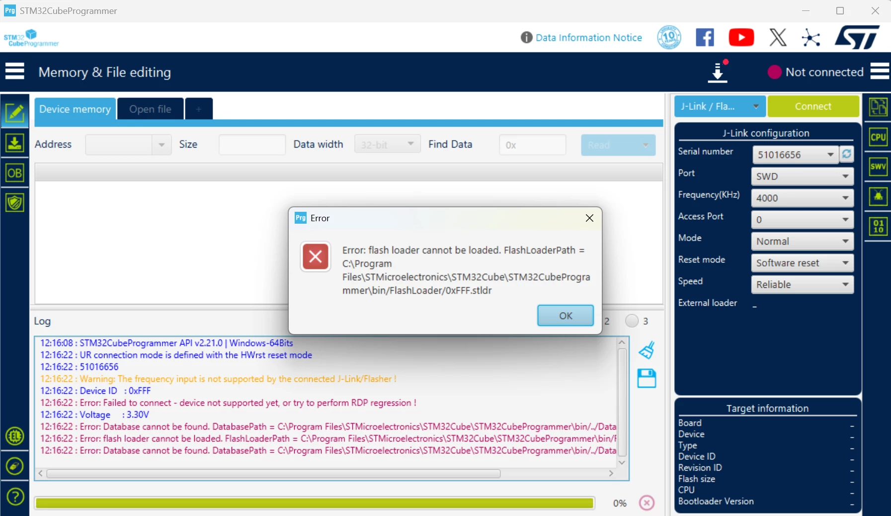

  • I also even tried with J-link
  • Target voltage is ~3.2V
  • access port is also changed from 0  --> 1
Still, device ID cannot be read.

  • Cube Programmer connection error with ST-Link_V_3 and J-link
NOTE: With J-Link the Device Id is Detected
Any help would be appreciated.

mƎALLEm
mƎALLEmBest answer
Mar 3, 2026 7:59 AM UTC
Hello  and welcome to the ST community.
That's a normal behavior. CM7 is accessible over Access port 0 while CM4 is accessible over Access port 3. If you disable CM7, the MCU target is no more accessible if debug access port = 0.
Set the Access port to 3 and you will restore the connection to your MCU target.
Please have a look at this article: How to enable/disable cores on dual-core STM32H7 using STM32CubeProgrammer
Hope I've answered your question.
