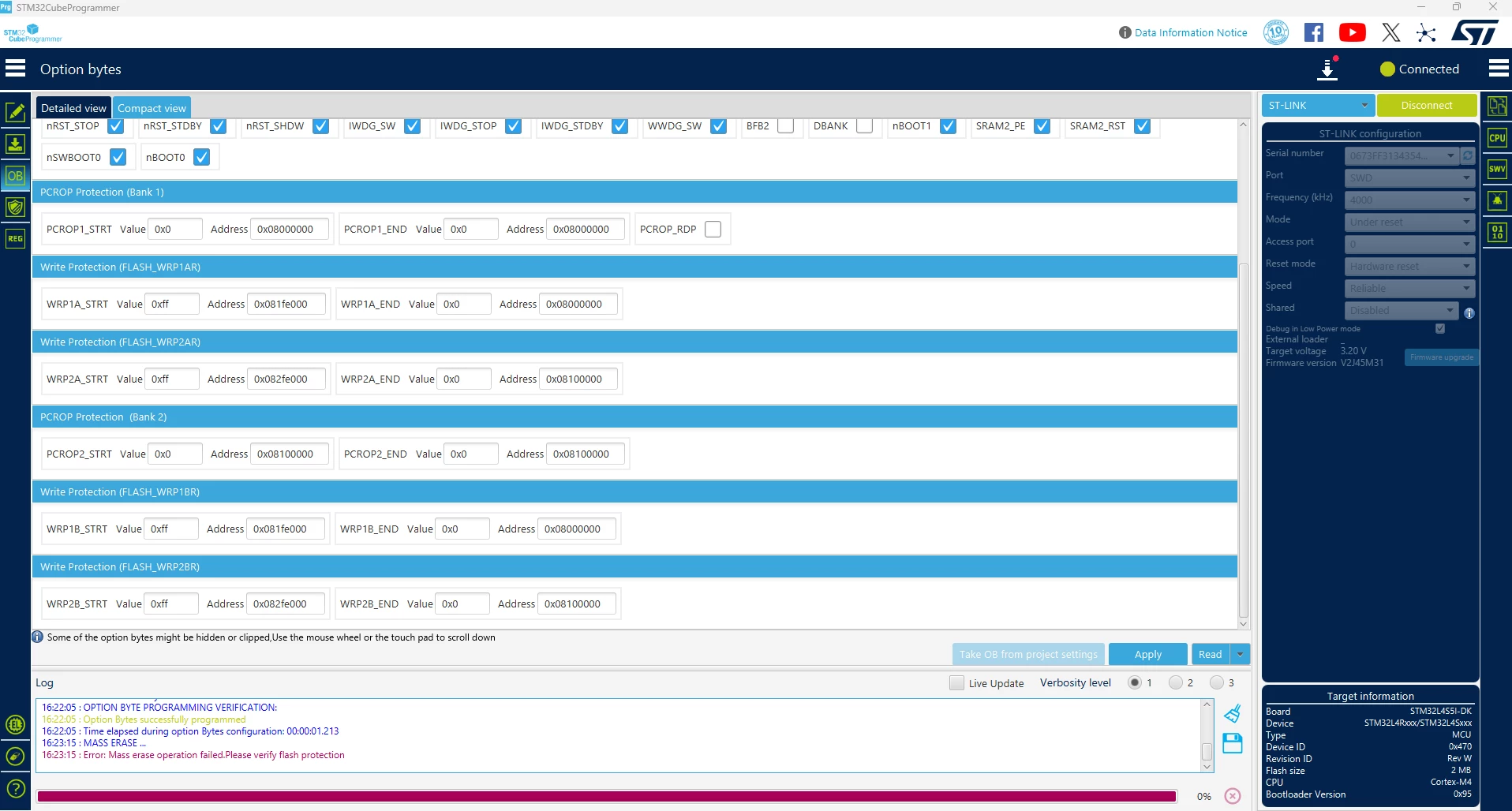

I'm using B-L4S5I-IOT01A board, Unable to program the board using stm32cubeprogrammer. Got Error: failed to erase memory. Tried to mass erase the chip, got Error: Mass erase operation failed.Please verify flash protection
here is the stm32cubeprogrammer CLI log for STM32_Programmer_CLI.exe -c port=SWD -ob displ command

Can someone guide me to disable the write protection in option bytes
Thank you in advance
