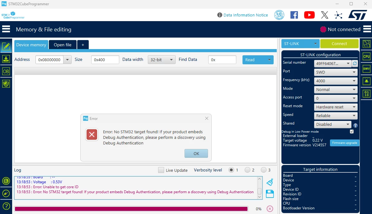

but unfortunately in my case I have to have "VDD_Target" signal connected on both ends. When disconnected STMCubeProgrammer responds with error shown below:
Do I need to have all SWD signals being connected in order to program my Prototype or is there any hidden option in ST-Link/STMCubeProgrammer that I can turn on, so in final design I can omit routing VDD pin for SWD connector?

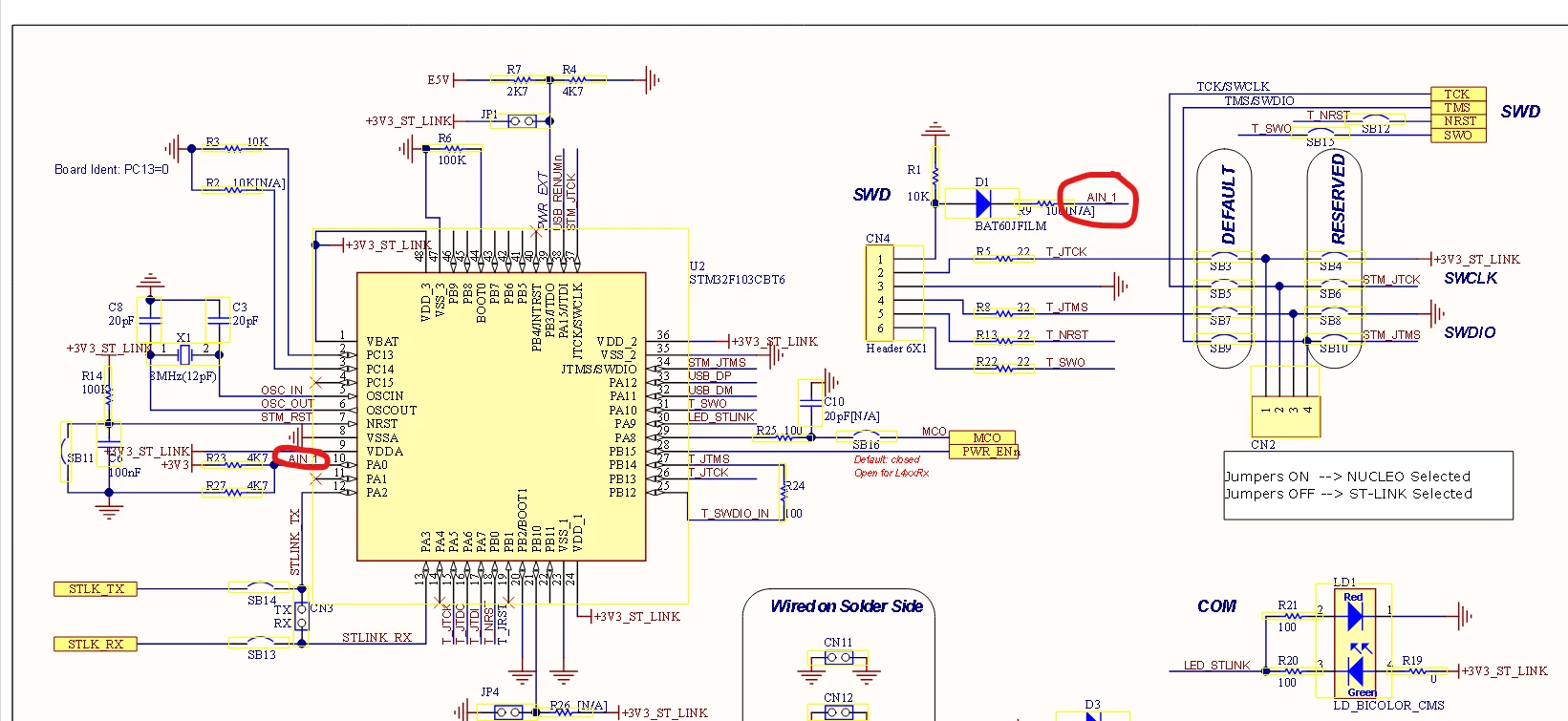

2. When using ST-Link from Nucleo Boards, there is no need for connecting "VDD_TARGET" to Prototype. From what I saw an Nucleo schematics (Document MB1136, p. 4):
there is a pullup resistor on the VDD_TARGET pin, so without connecting it to the Prototype, pullup provides a valid voltage to PA0(AIN_1) Pin

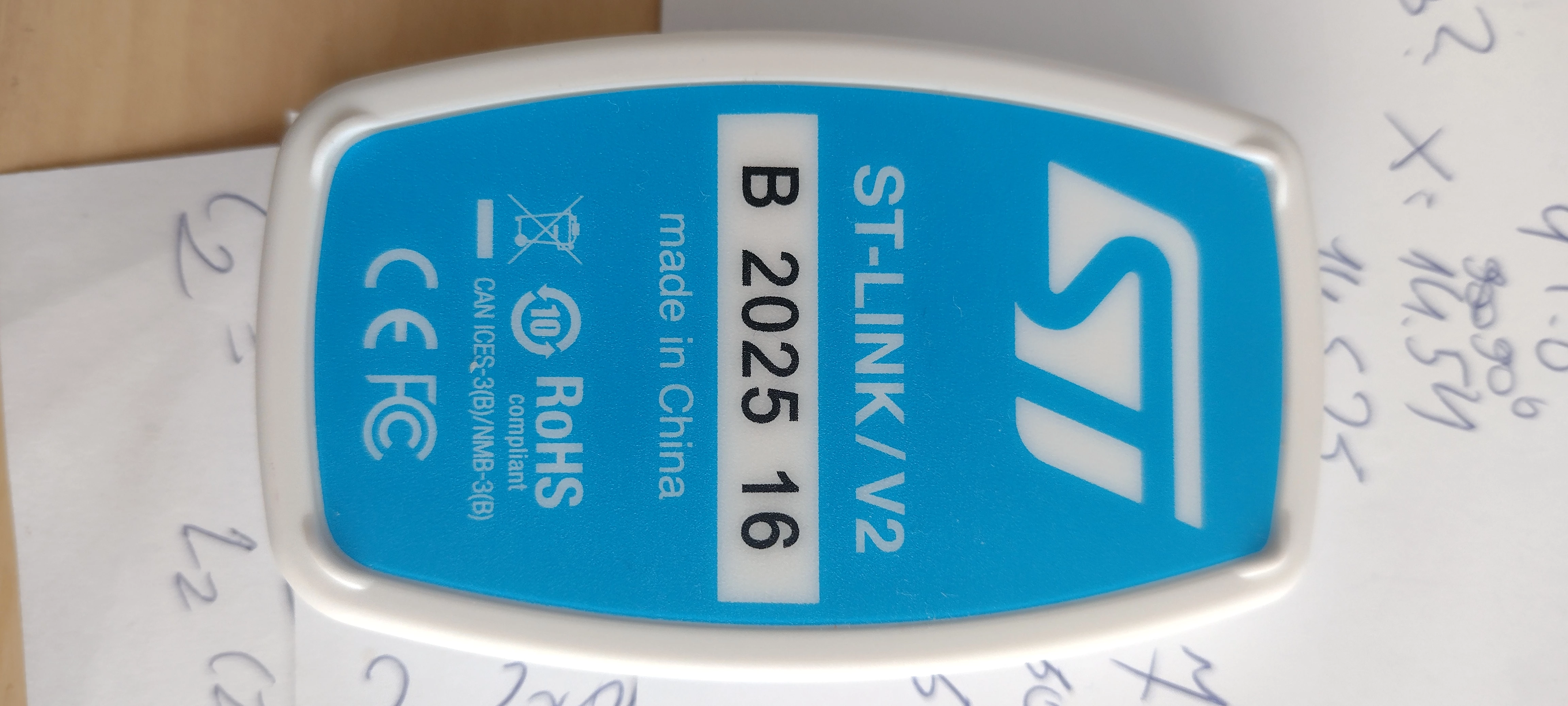

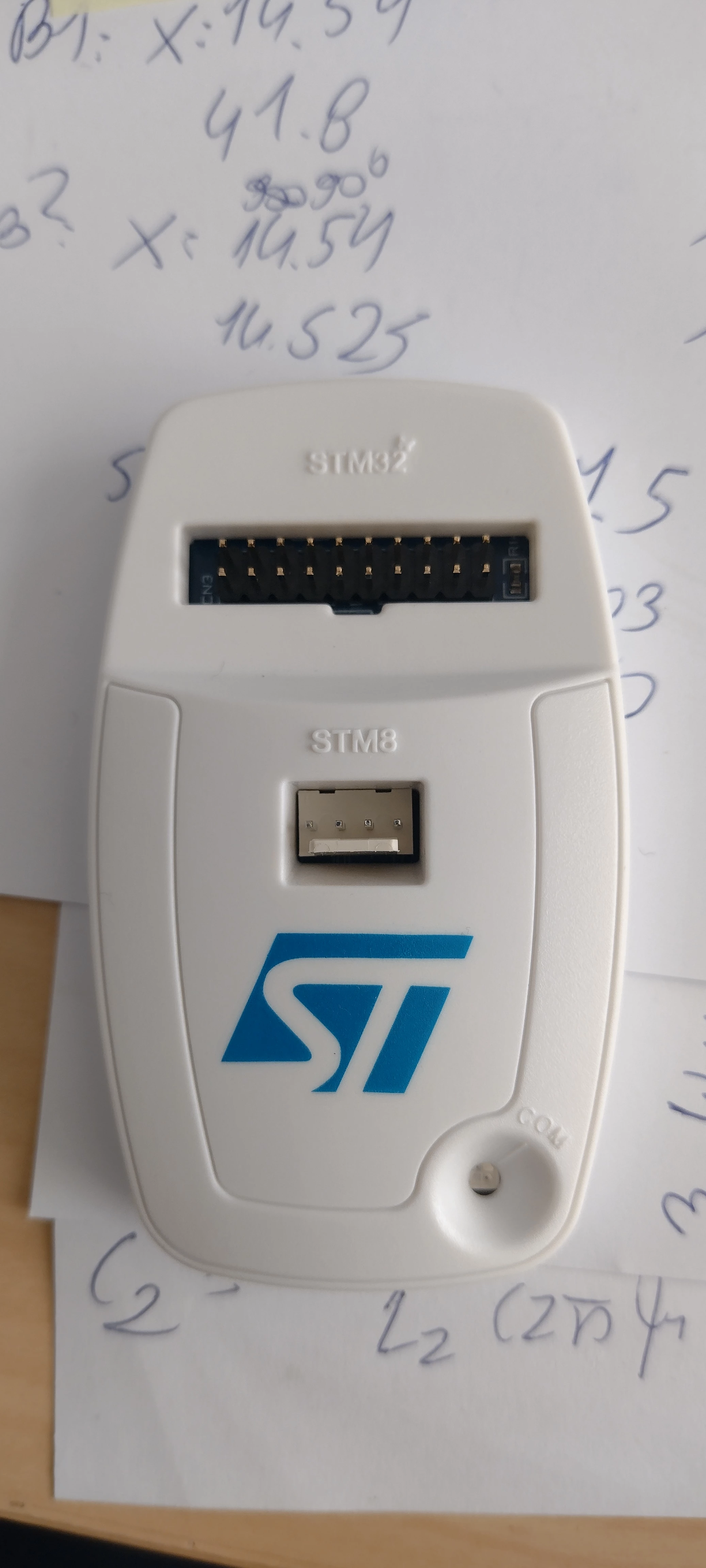

Well, apparently it doesn't work for me. I bought ST-Link V2 from TME Retailer:
https://www.tme.eu/pl/details/st-link_v2/programatory/stmicroelectronics/
Here I provide pictures of both sides of my model:

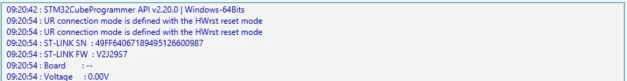

And CubeProgrammer shows such properties of ST-LINK (Prototype not connected)

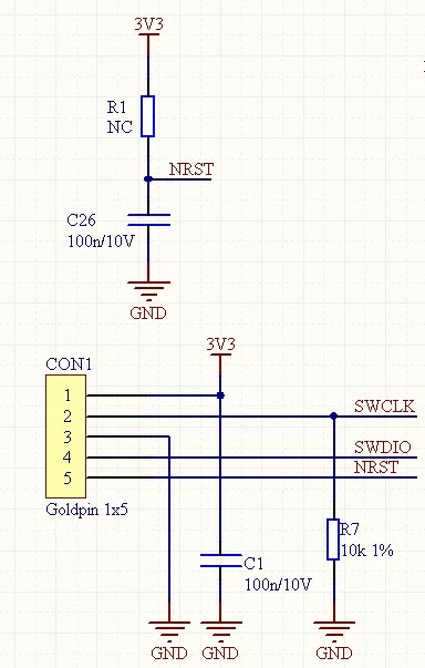

The Prototype's schematic for SWD connection is depicted below
Still, when connecting Prototype to ST-Link and clicking "Connect" button in STMCubeProgrammer while having "VDD_Target" pin disconnected, it shows the same error from my original post. Do you have any other ideas? Any at this point would be helpful.
September 10, 2025
If you're out of ideas, connecting the VDD_Target pin to 3.3 V so the voltage is displayed in STM32CubeProgrammer correctly and trying to connect seems smart. There are pins on the programmer than supply 3.3 V. Maybe it does have level shifters on one side, or maybe it requires a certain voltage before it even tries.

Hi Marek,
what do you mean with "CON1"? Is it a cable to the external ST-Link shown in the picture?
(The pin designation looks like the embedded ST-Link/v2 from NUCLEO boards. The external ST-Link has a completely different assignemnt on its 20 pin connector for STM32.)

mfgkw: that is correct, CON1 is a soldered male goldpin row to which I attached F2F goldpin ribbon which is connected to corresponding pins on 20-pin ST-LinkV2 header. We originally used Nucleo ST-Link but it turned out to be little unresponsive so I exchanged it for proper ST-Link. The electrical connection is solid, I assure you.
